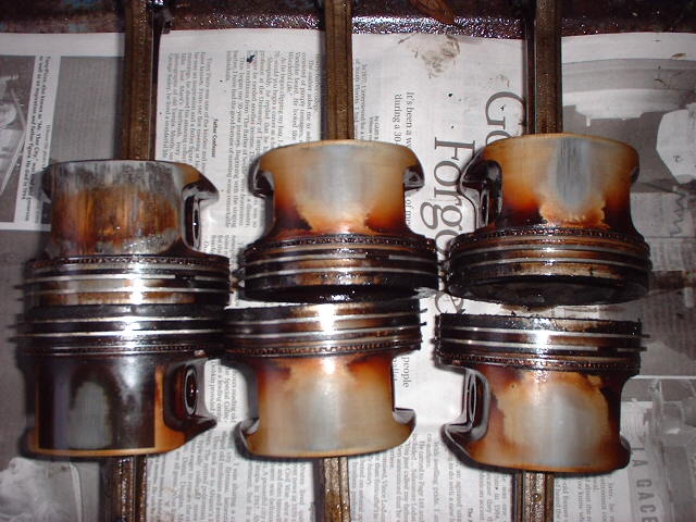

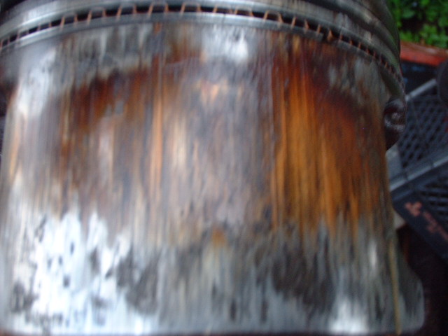

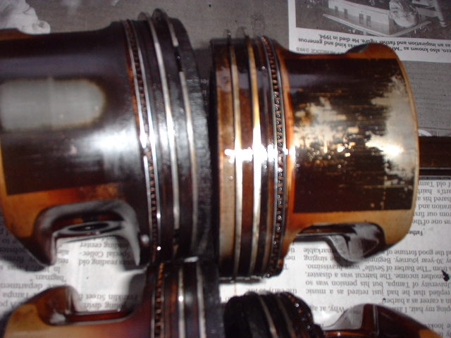

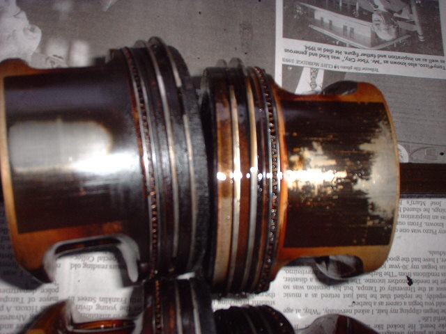

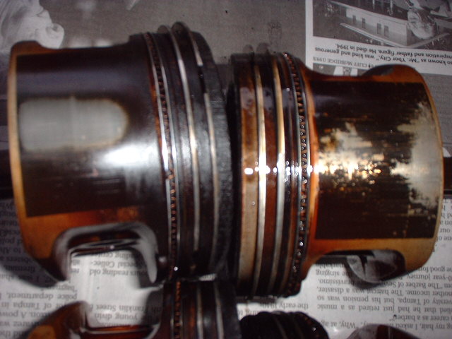

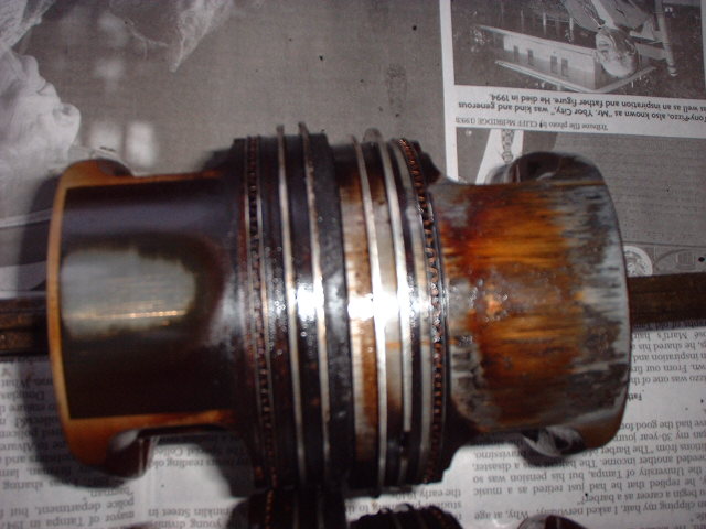

I broke the engine down eager to look at the internals to see what effect the turbo had on the engine. The pictures tell the story, GM knew all along pistons # 5 & 6 were a trouble spot, I can't believe they put two different types of pistons in the same engine, pistons 5 & 6 were the only ones that had the antifriction patch and no it wasn't rubbed away on the others.
Nearly all of the pistons had excessive clearance especially # 6 which was probably going to let go any day soon. Despite occassional detonation and high revs the rod bearings looked great, not a hint of copper or the excessive wear that I was use to seeing on 2.8L bearings from a high mileage engine, they looked so unremarkable I didn't bother to pull the main caps.

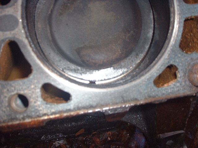

The worst of the pistons was # 6 and they are head to head in opposing pairs 1-2, 3-4 and 5-6. Look at the ring gap on number 6 in the bore. It's amazing number 6 was still in one piece, and nearly all of the pistons had excessive bore clearance but 6 was the worst by far.
