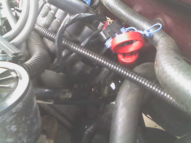

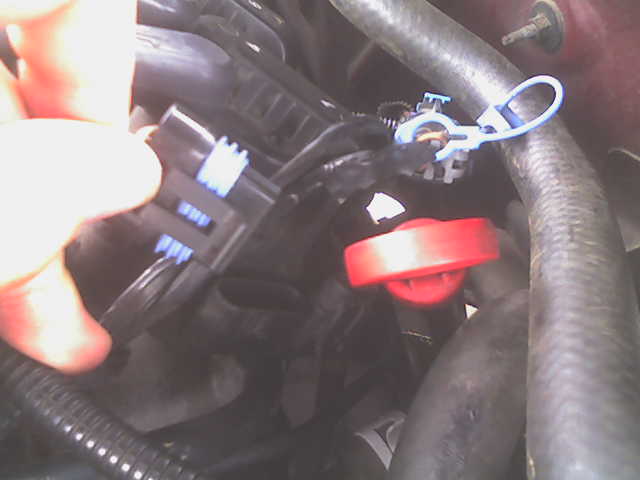

    Please excuse my auto-tard self, but what is this 5-pin thinger right on the coil pack? Photo attached.
    For some reason it dramatically reduces the knock in the mornings or at any time of day if it's disconnected. Granted it cruises like shit (stumbles a little) but it dead silent when cold. When it's connected it runs fine but sounds like shit. Wires are too messy to trace, guessing it might go into one of the relays but who knows, I'm hoping someone here might know offhand or has a wiring diagram and would let me know
    (sorry for crappy cellphone pics)
    Umm... I'd keep that plugged in if I were you.
    That connector is the connection between the ICM and the ECM. Withou that plugged in, the ICM is controlling the spark, NOT the ECM. And that is not a good thing.

        The coils will be reverting to static timing, based solely on input from the crank trigger. I know the car will run with one or two wires disconnected, but all of that plug disconnected? I'll have to try that.

          should be 0 degrees advanced.. i bet that's why thers no knock..

                    The injectors shouldn't goto 100% all the time. They will go to a "fail-safe" mode that is factory programmed into the PCM. The ICM is also now in "fail-safe" mode and controlling spark independent of the PCM.
                      The ECM would rely on the Mem-Cal for stored information on recall to limp-on mode, truely most cars would run like crap with the connector unplugged. The ECM tracks little info bits over the engine milestones and is able to block learn the fire of the injectors and fall back to batch pulse according to recalled pulse per rpm curve and A/F.
                      Something either fell out of time mechanical or software or the engine has a mechanical problem that needs to be addressed.
