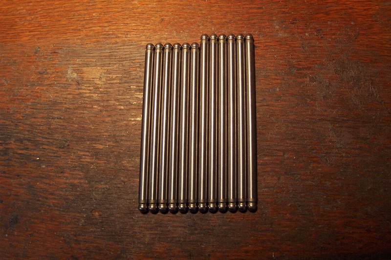

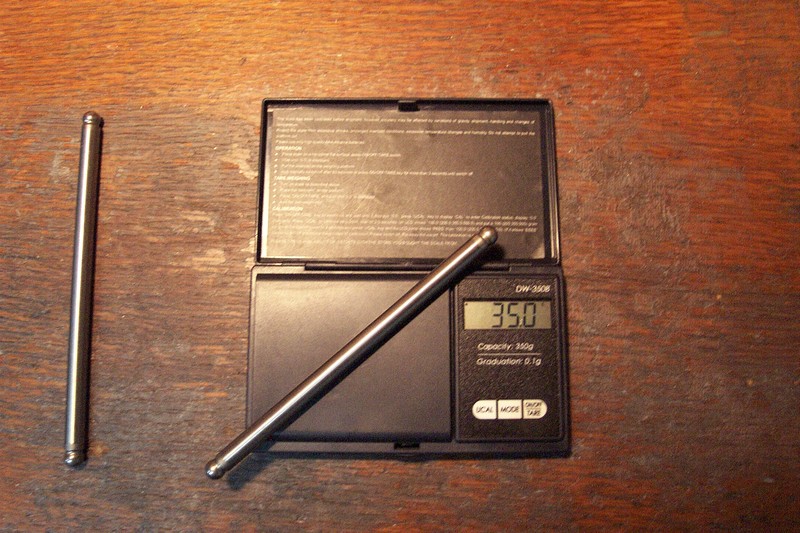

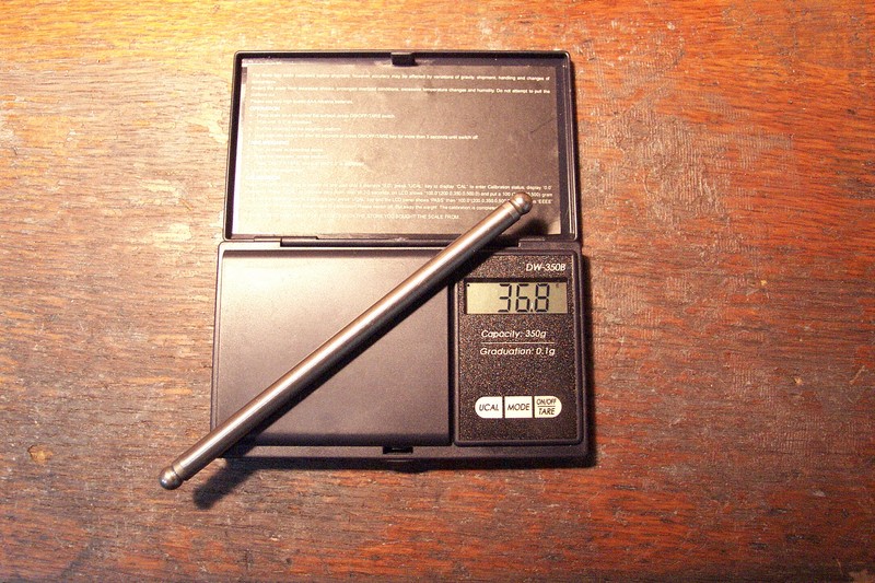

    I got the new lightweight pushrods. I was told they must have sent him the wrong ones last time, but he has the black ones pictured too. The thin wall are silver.
    So, here are the results.
    1/2 gram lighter for the intake, 4/5 gram lighter for the exhaust.
    Or 2% lighter, whichever sounds better:P
