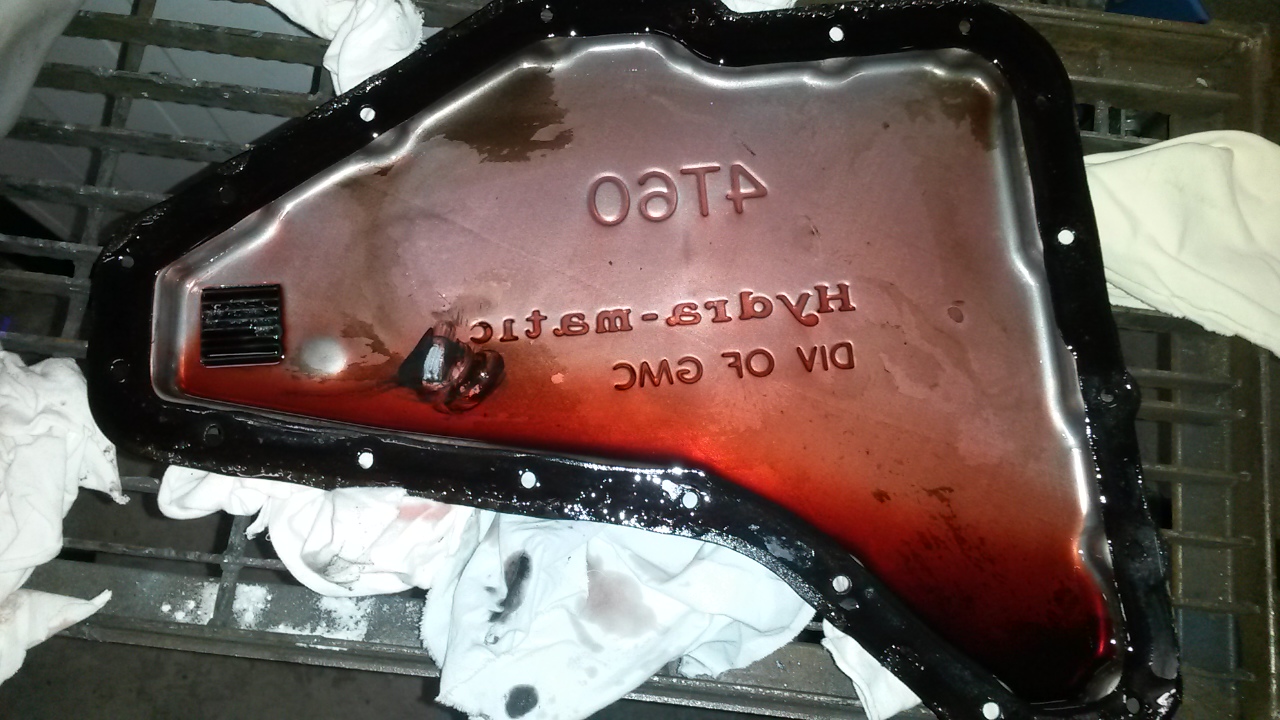

What happens is when you romp on the pedal to accelerate and the transmission goes down a gear it does so with a very hard hit from 3-2 and to a lesser degree 2-1. The car seems to shift fine up and down. I don't think it's slipping and I have a filter to swap in once I get the underside degreased. I readjusted the TV cable with little effect, but I also noticed the fluid is 2mm above the full mark once fully warmed up. One guy recommended a solenoid was bad, but I think that'll require dropping half the subframe out to get at.
Looking for advise or suggestions on what else to test and try out. If the transmission will need rebuilt it may just end up a scrapper car as I don't have an engine lift and already put 12+ hours into the intake gaskets.
