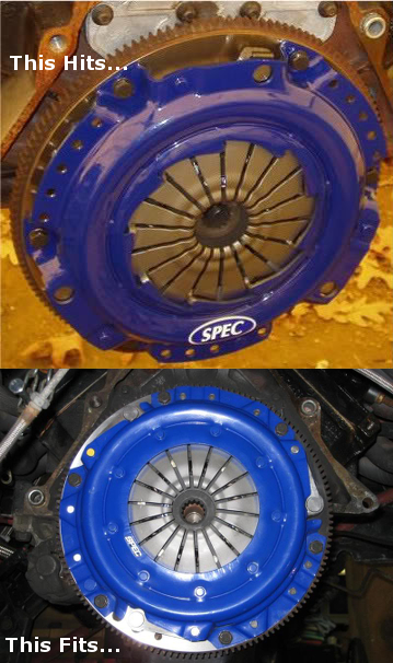

                        One more. Should I get a higher rated clutch or will OEM replacement be okay.
                        Sent from my iPhone using Tapatalk
                          I would be more concerned with the design of the pressure plate... if you use a clutch meant to be used with the 2.2 you should be fine, but if you go with a larger diameter V6 clutch this rule has been followed successfully in the Fiero world:
                          - Ben
                            Okay. So 2.2 flywheel and clutch. Prolly go with something like a spec stage 2 if it's available. Heavier car more power(I could be wrong)
                            Better safe than sorry. Had a stage 3 in my 240sx, don't ever wanna go that far again with a street car.
                              Yeah a stage 2 is a good idea. But if you can find a stage 2 V6 clutch with a pressure plate that will clear, that would be a better solution. Look for clutches for a 3.1L Cavalier or something like that.
                              The V6 clutch has a larger diameter disc which should be capable of handling a bit more power with the same material.
                              '86 Fiero, 3500, 4-speed
