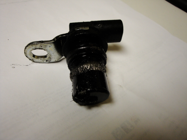

                        My F40 is failing. After a couple of 11 psi runs yesterday my odometer stopped working and I heard a faint whining sound immediately after both runs that went away after llight driving.
                        I removed my VSS sensor after confirming power to my odometer and Dakota signal converter and noted it had "metal hair" on it along with a chip in the plastic casing down to the coil winding which had been damaged knocking out the signal.
                        Not sure if it's failing because my 4.2L and base 3900 under boost produced more power than it could handle, or if it was already injured from the wrecked car it was salvaged from. Not sure of the initial miles but I've put about 10k on it.

                              • #30
                                Take a look inside the F40 and note the nylon caps at the ends of the shift forks, perhaps one of those came off and came around on the final drive and took out my VSS;
