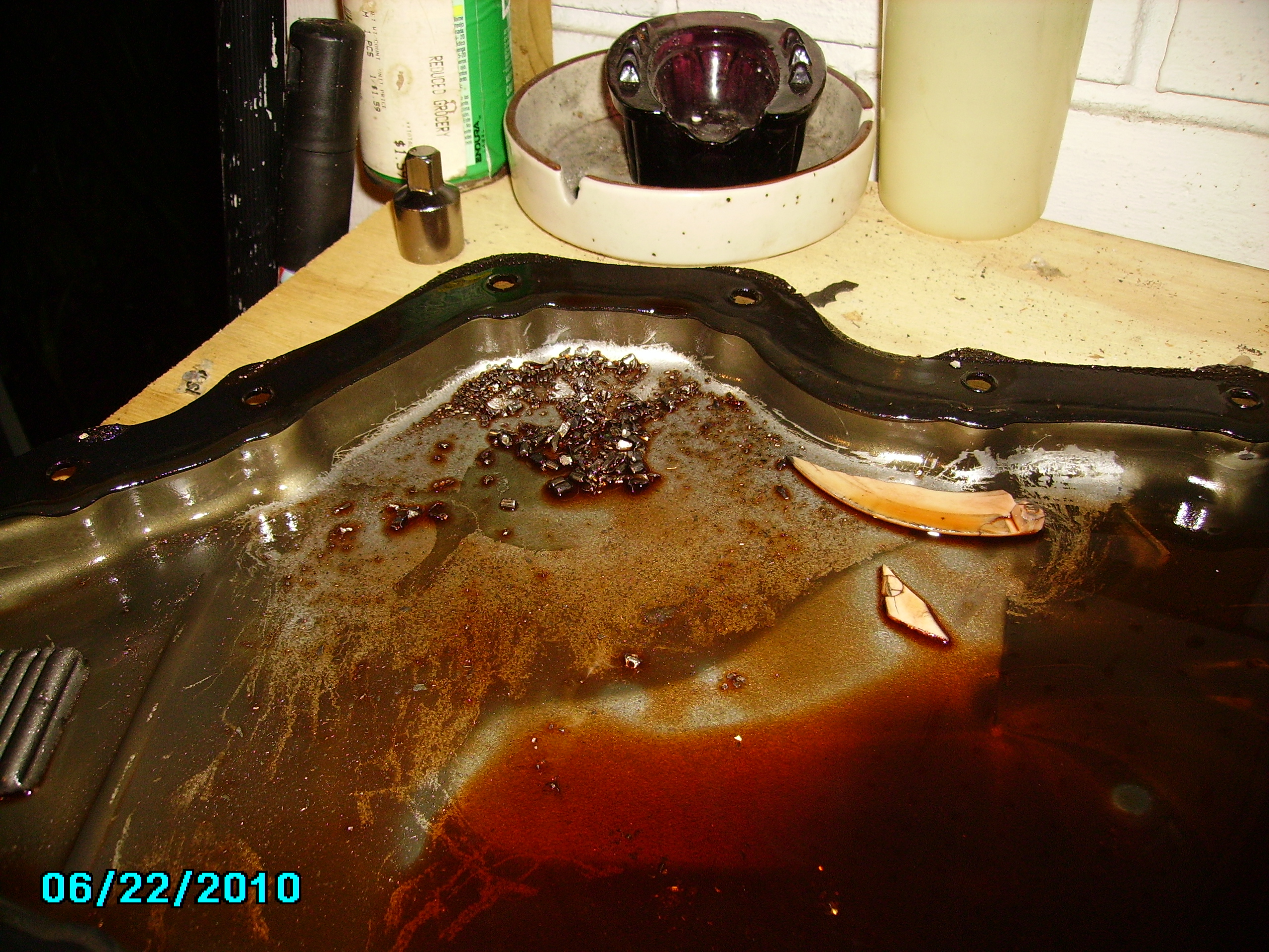

Hi, long time lurker, first time poster. Usually problems relating to the car have already been answered here but now I have a newer problem that I need some assistance with.
This is from a 97 Monte Carlo 3.1 with 163k miles. Trans fluid/filter was changed at 60k and 123k miles and has no leaks.
I noticed a grumbling/grinding noise when sitting idle and accelerating. The noise went away in 3rd gear but came back in 4th. The noise happens when in park, reverse or drive. I decided to drop the pan and found this:
![Click image for larger version
Metal chunks, small rollers, 2 plastic pieces, and a black film all over the pan.
Changed filter and fluid, put it back together and it still makes a horrible low pitch grinding noise. The car still drives.
So, any ideas what those pieces are? Would it be worth my while to rebuild the tranny or throw in another used?
