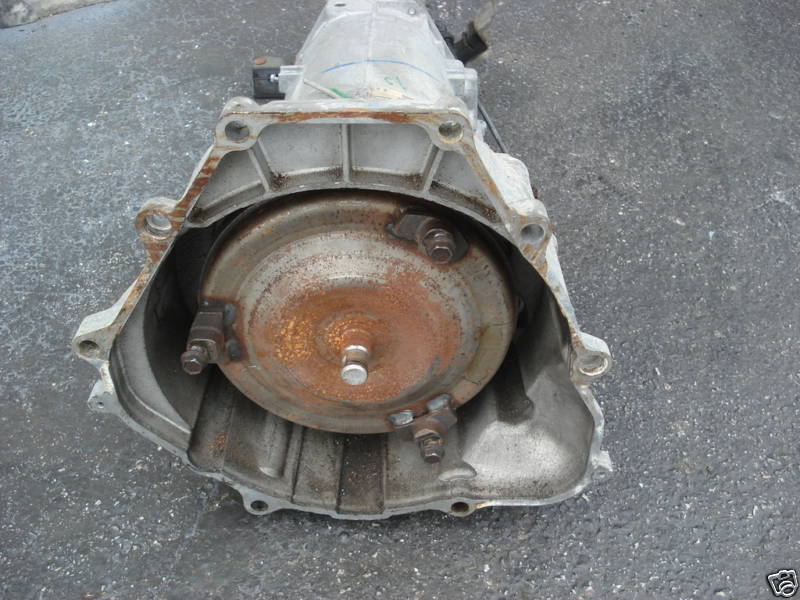

      Well, in my browsing last night, I think I finally found a solution! It appears that the 97+ F-bodies with the 3800 also have the starter on the driver's side. Since the 97+ 4L60E's have a removable bellhousing, I can use an F-body bellhousing and bolt it up to any 97+ 4L60E, including ones from TCI capable of 600hp (Super Street Fighter series). Here is a pic of a 3800 4L60E bellhousing...

      • #18
        good deal, TCI tranny controller as well?
        • #19
          Badass!
          • #20
            But, of course. Well, that is unless someone like FAST comes out with an all-in-one PCM that will allow control of the engine and tranny. I still have several years until I'm to that point, so maybe it will be available when I need it.
            And yes Dave, I was thinking the exact same thing. Honestly, I'm suprised it hasn't come across the site(s) in the past, since its been an option for over 10 yrs now.

                            • #29
                              As I stated above, now that I found that the 97+4L60E comes with the correct bellhousing, I will be going that route instead of the T5. I will probably just go with a stock one for now until I can save up the +3k for the TCI one. I will probably keep the electronics and get a controller for it so that I can mess with the shifting abilities via a laptop.
