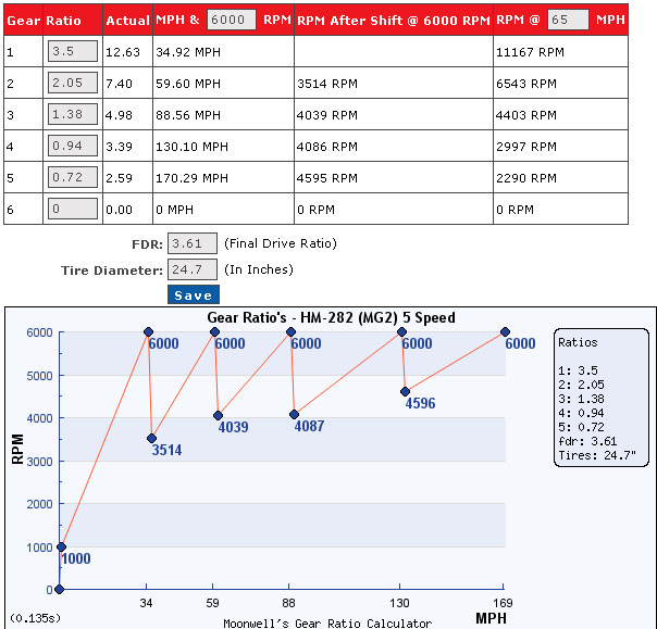

        Here are some ratio comparisons..
        *edit, not sure why they are showing up so small when you click on them. I'll put them on my server tonight and link to them.
        *edit 2, fixed.. the site was converting .gif images to .jpg.. weird..

                      Not sure if the FDR would be 3.61 or 3.94, but the differential should be the newer design (beefier). Other than that, only 4th and 5th should be different, gear wise. 4th: 1.03 vs 0.94 in the '89, 5th: 0.81 vs 0.74 in the '89. Certainly wouldn't be helping out your highway mileage.
