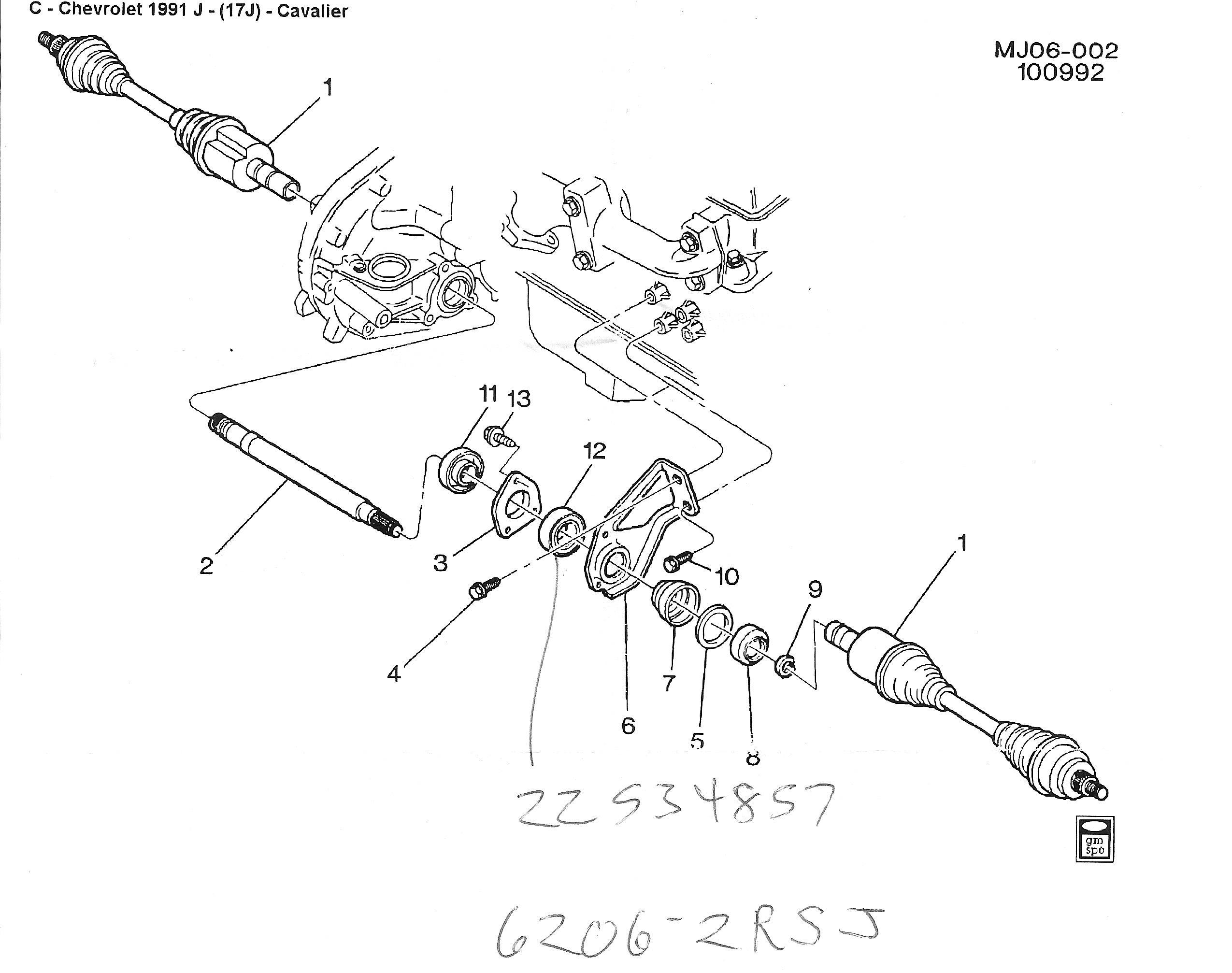

    I trust these guys, so I call GM to see what the entire unit costs. They tell me it's sold in individual parts. I get them to fax me over a break down and I'll call them back. Sure enough, all the parts are listed seperately. I call back to see about availability and price, and I'm told all parts are discontinued except the actual shaft. At this point, all I'm really concerned with is the bearing. He gives me the part number and I proceed to interchange the number on our system at work. And go figure it crosses over to a number that I stock in my store for a whopping $14 CDN.

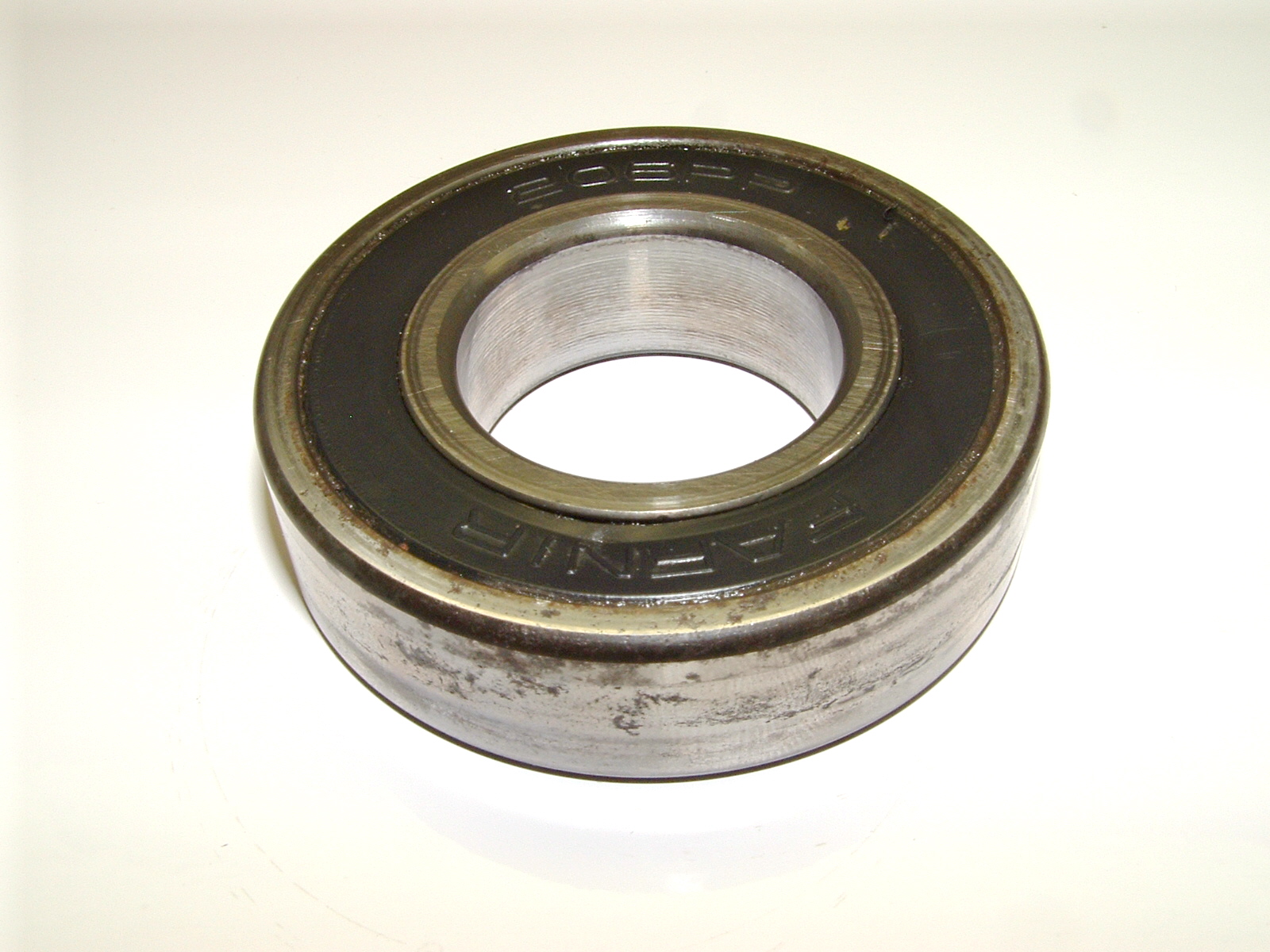

    So I clean up the old bearing to check for numbers. It's stamped with FAFNIR 206PP. Again, I proceed to interchange it, and come up with the same number I did before.
    Here's the bearing numbers I've got.
    GM #22534857
    Bearing that came off my car-Fafnir #206PP
    Timken/National #206FF
    Spicer #550735
    Chicago Rawhide/SKF part #6206-2RSJ
    I don't know if these bearings are the same for all GMs, but mine is from a 1991 Cavalier.
    I've posted pictures of the bearing and break down I got from GM.
