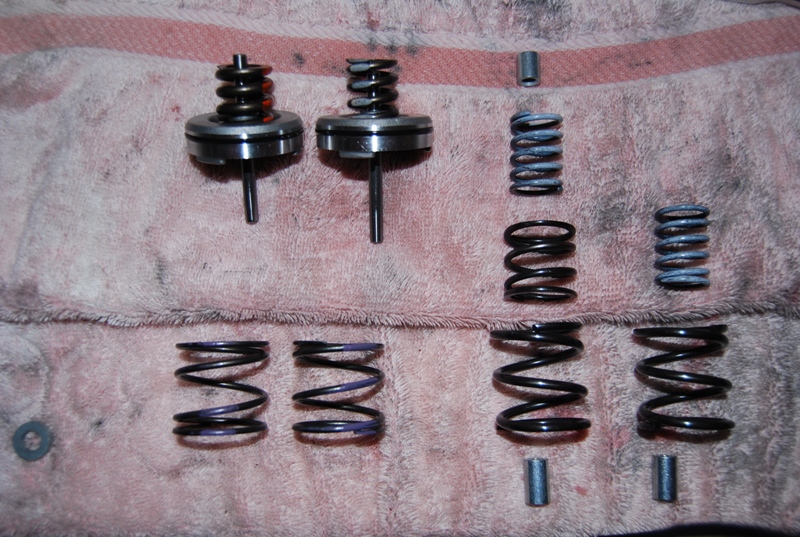

                            • what are the length of the shims you used? as installed in the tranny, below both pistons usually use 3/4" and above 1/2 inch. you can also install stiffer springs and increase line pressure. it's best to not have the tires break loose during the shifts. that's hard on non-upgraded parts. you should have a vacuum modulator that controls the line pressure. you can get an adjustable vacuum modulator that can be adjusted by turning a small screw. my 97 lumina shifted quite crisp with no other mods. just be sure you don't max your pump out or you'll damage it quickly. granted, i have the 4T65E, but this picture may help to give you a better idea. on the left is the stock set up, on the right is the TransGo shift kit. the single springs on top--i bought another orange (2-3) spring to replace the white (1-2) spring.
                              you can also do it yourself with the following parts: The shims used are available from McMaster-Carr online. NOTE: this is for a 4T65E. i don't know if the piston pins are the same diameter.
