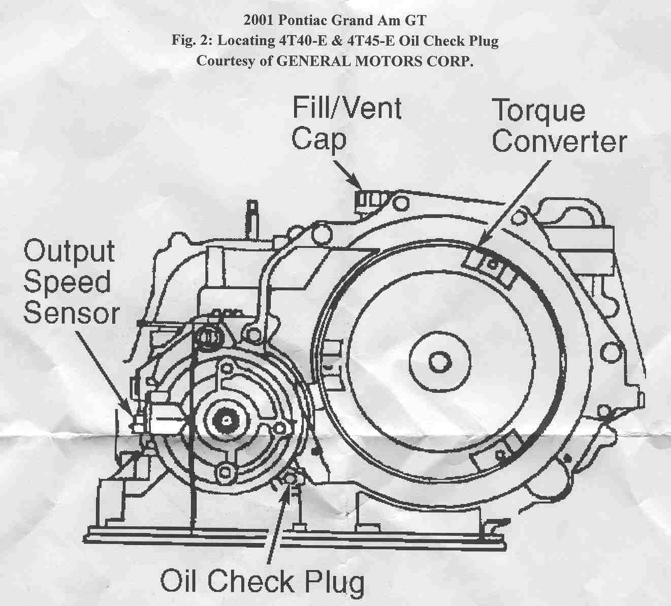

                    There should be a plug somewhere on the side of the transmission you can use to get the level right. Just make sure the car is up evenly on all four sides and remove the plug before you fill it. When you think it's almost full, pour slowly till the fluid comes out the hole. Then put the plug back in.
                      its on the front. if you look around on grandamgt.comn theres a thread on how to install a trans temp gauge and where you put the gauge sender is the plug where you would check the fluid

                        awsome... thanks. my trans shudders a little when the throttle is held just so and it shifts from first to second, other than that it will shudder a little WOT shifting too... i think she's going to pack it in on me
                          posted a pic of where it is
                          alright heres a page from pfyc.com on how to install a trans temp gauge just use it for the driections on where the hole is

                            for the shudder you could just be low on fluid
                            unless im real low, a half a bottle didnt seem to cure it...
                              try the trick with the pic i posted. you do it with the car running and it should dribble out the hole.
