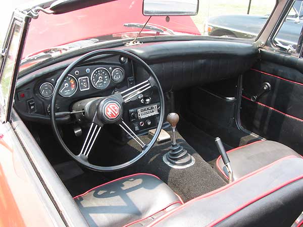

                Believe it or not, no, no modifications to the interior. I set the engine as far back as possible and the shifter came up through the standard hole. The tranny is one that is tilted at a 17 degree angle so the shifter had to be cut and rewelded. I actually used the original MG shaft and welded it to the T5 shifter. I think it looks stock.
