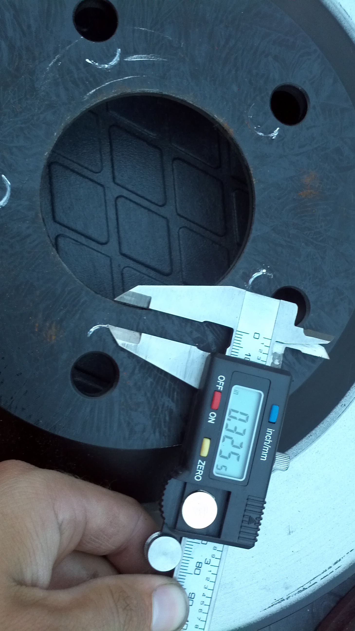

    so im collecting parts for my brake upgrade. some info I found online was wrong about MY stock hub size.. should have measured my self instead of being lazy lol. the plan is c5 vette everything (yeah ebrake is gonna be a bitch), and I plan on a dual master cylinder witha bias bar. IF my info was correct I was going to bore the center of the rotors out a few mm and redrill them, no big deal. the vette rotors have bigger hubs than the beretta so im going to have to have centric rings made, not a huge deal I guess and in the long run it will be easier to swap rotors.
    my main concern right now is once I redrill the rotors will I have enough meat between the hub and the lugs? Dont want any cracking issues.. too much money and work for that. I do plan on getting a few expert opinions from shops but I know a few guys on here know there shit, more opinions I can get the better!
    to me it seems questionable.. were talking .325" of meterial if you dont feel like clicking on the pics, and Im not drilling it on those marks, it was just to get an idea of what im looking at

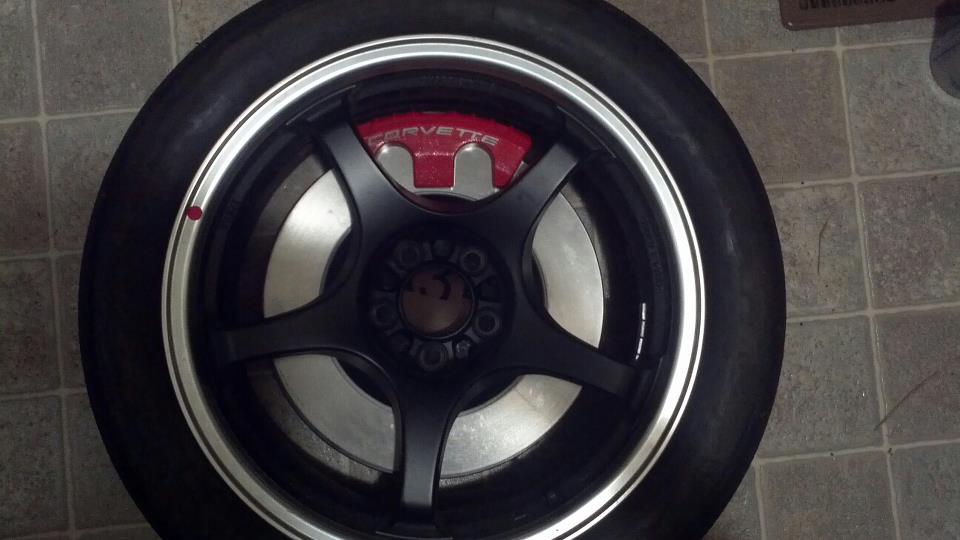

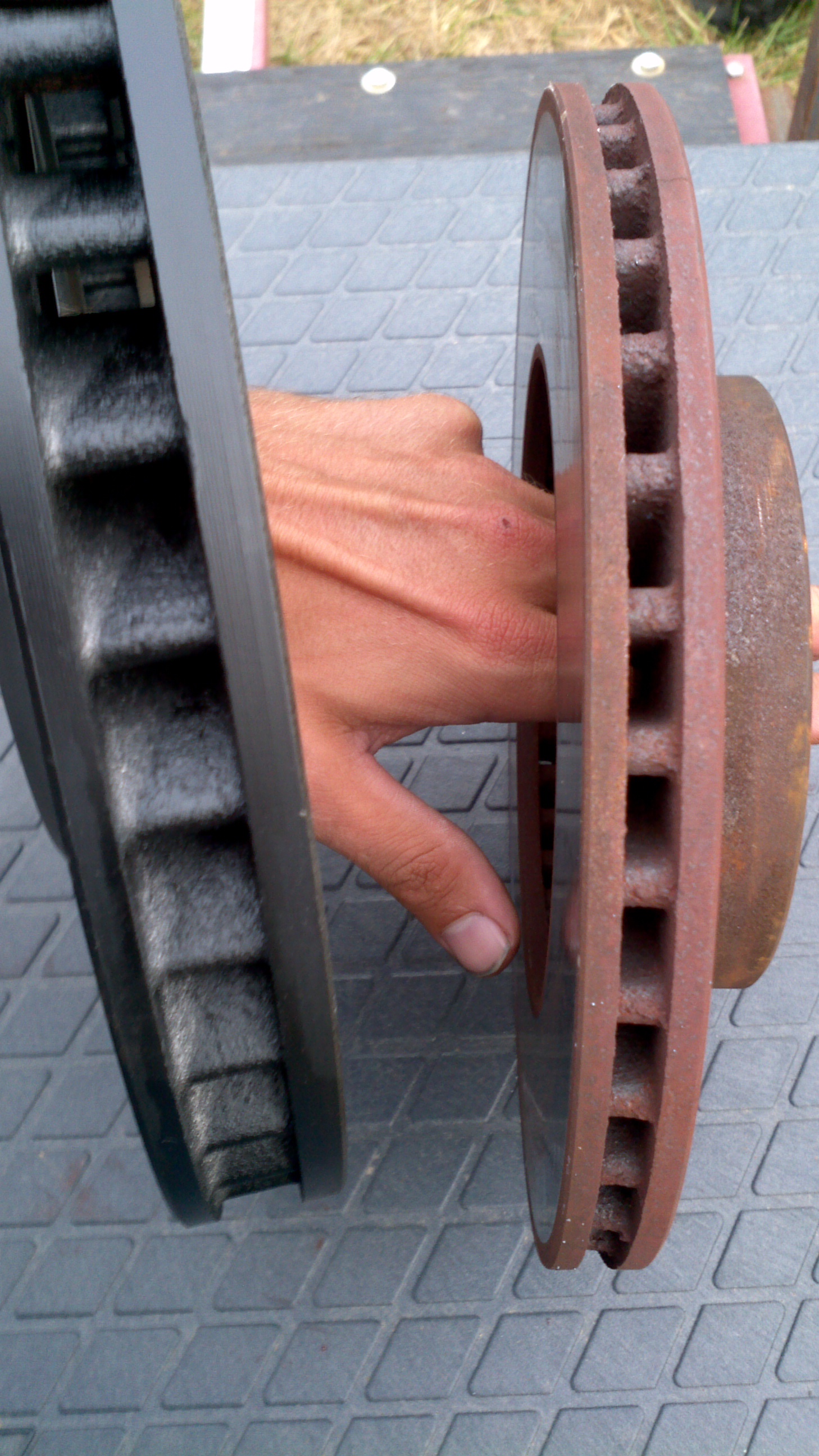

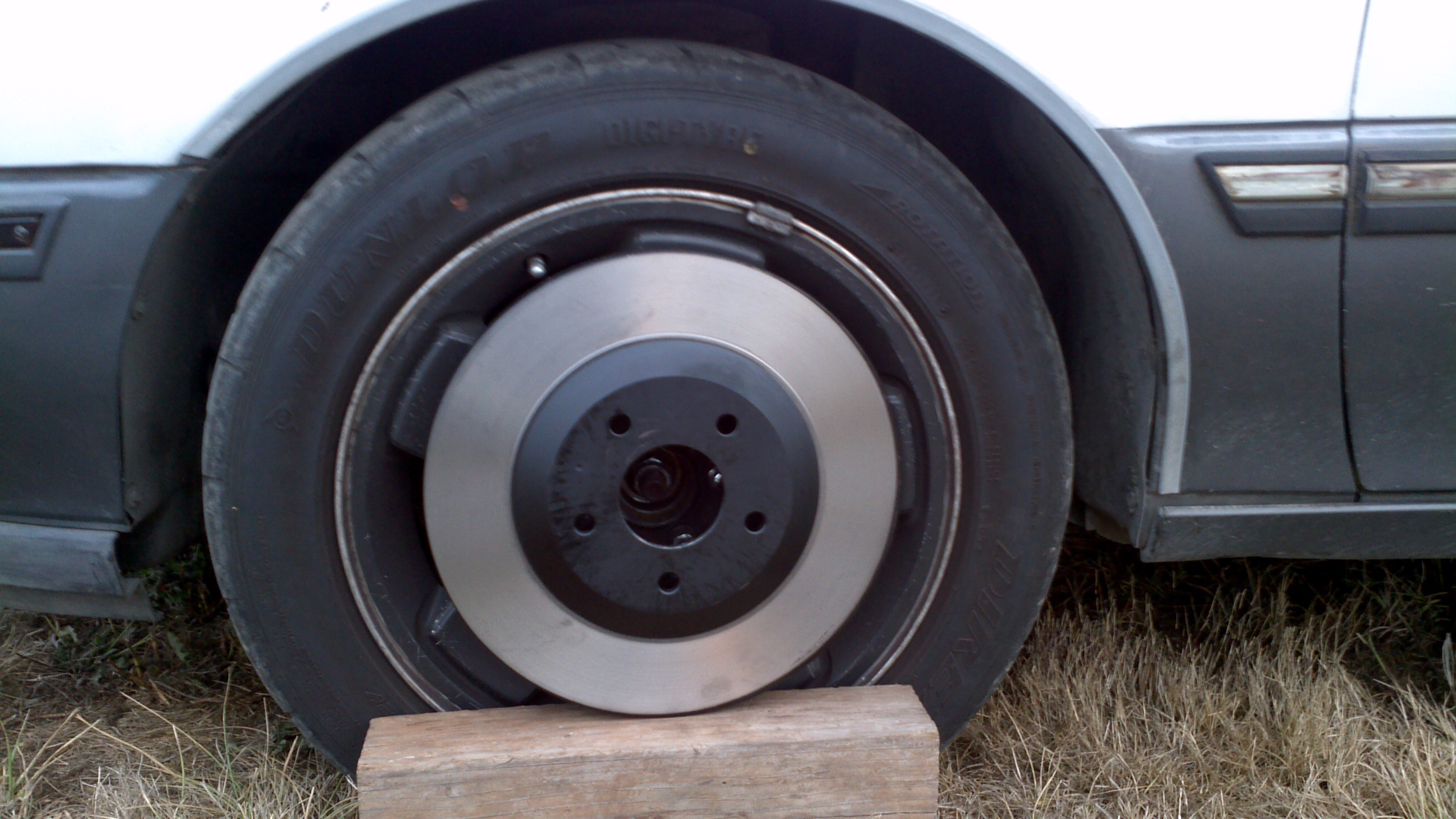

    I would opt for the 12" F-Body's with the N-body knuckle/bearing and also try the stock 11" N-body rotors with good pads to see which combination you like better. Honestly I think you will slow yourself down more than you expect putting that heavy 13" rotor on there. The 12" Camaro setup took a half second or so off my ET when I went up from my 96 rotors to those, It's a lot of extra rotating weight. Also IIRC you can not fit that 13" setup behind a 16" Beretta wheel... Hell Geoff needs his 17"s to clear the 12" F-body rotor with the Vette caliper.
    Regarding the drilling though, remember most of the holding force is done by the fact the rotor is clamped between the bearing and the wheel with the studs, so the "thin" material in that area shouldn't matter that much.
      With the C4 brakes on my car I need 17" minimum wheel (I know he is doing C5, but still). Stock Lumina 16" wheels do not fit, nor the 16" GP Crosslaces which I believe are supposed to be bigger inside than the Lumina wheels.
        The inside of a Beretta wheel is VERY small... So can guarantee with a 13" rotor it will not fit.
        12" brake upgrade someone else did on a beretta with 17" rims
          13" C4 in an 18" rim.
          IIRC the gap is about 3/4-1".
            yeah there is NO WAY they will fit under the gtz wheels, the rotor almost doesnt fit alone lol. fronts are 12.6"x1.6" and rears are 11.8"x1.0" and directional (cooling groves are angled)

            I have yet to weight the c5 rotors compared to stock but If i lose the gtz wheels (22 or 24lbs?) and get something lighter (my 17s are 15lbs) I figure ill be close to the same rotating weight. I do plan on adding more power about the same time I do the brakes. I really want to stop cracking rotors, melting caliper sliders and killing wheel bearings due to heat, along with having no issues stoping. plus ANY pad I could ever dream of.
              thats inside a 17" might have half an inch of clearance from the caliper lol. but thats with no pads or brackets so its a rough guess on where it belongs
