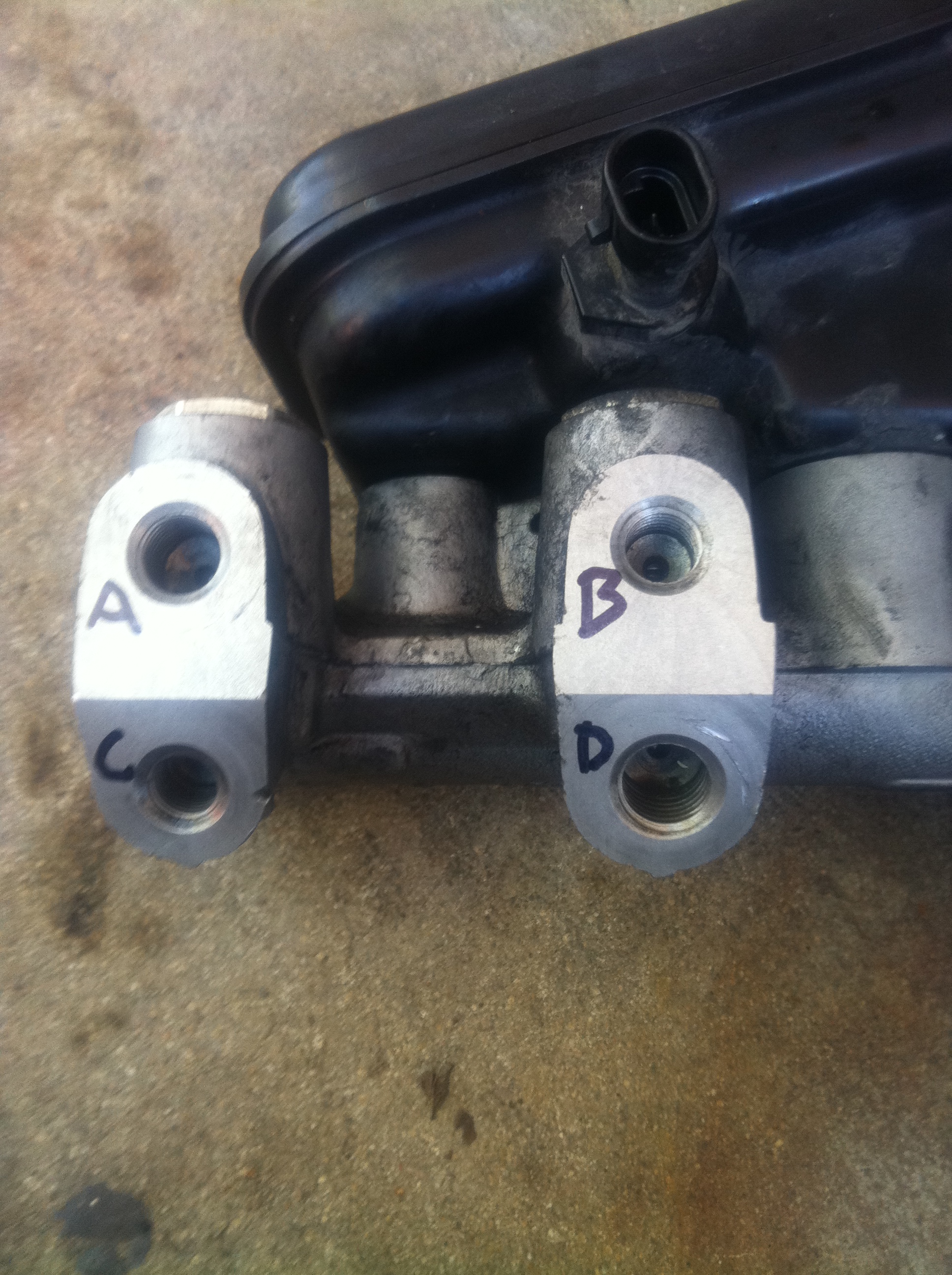

          I'm trying find which line from which wheel goes to what port on a non-ABS master cylinder
Name:	beretta master cylinder.jpg
          Port A= LR, LF, RR, or RF?
          Port B= LR, LF, RR, or RF?
          Port C= LR, LF, RR, or RF?
          Port R= LR, LF, RR, or RF?

            Trace them back.... The front two should be easy, And the rear should be the same for left and right. Your a should be front left, the one behind that should be rear left. I'm not exactly understanding how and what the problem is, unless you have a bunk master, oh btw, did you bench bleed the "new" master? Otherwise your chasing your tail.

              I know what line goes to what brake I was trying to find where they go on the master cylinder. Yes I bled the new master cylinder and it is new the one from the pic was a junkyard one.
              I went to the junkyard on my lunch break today and the ports are A=LF, B=RF, C=RR, D=LR
