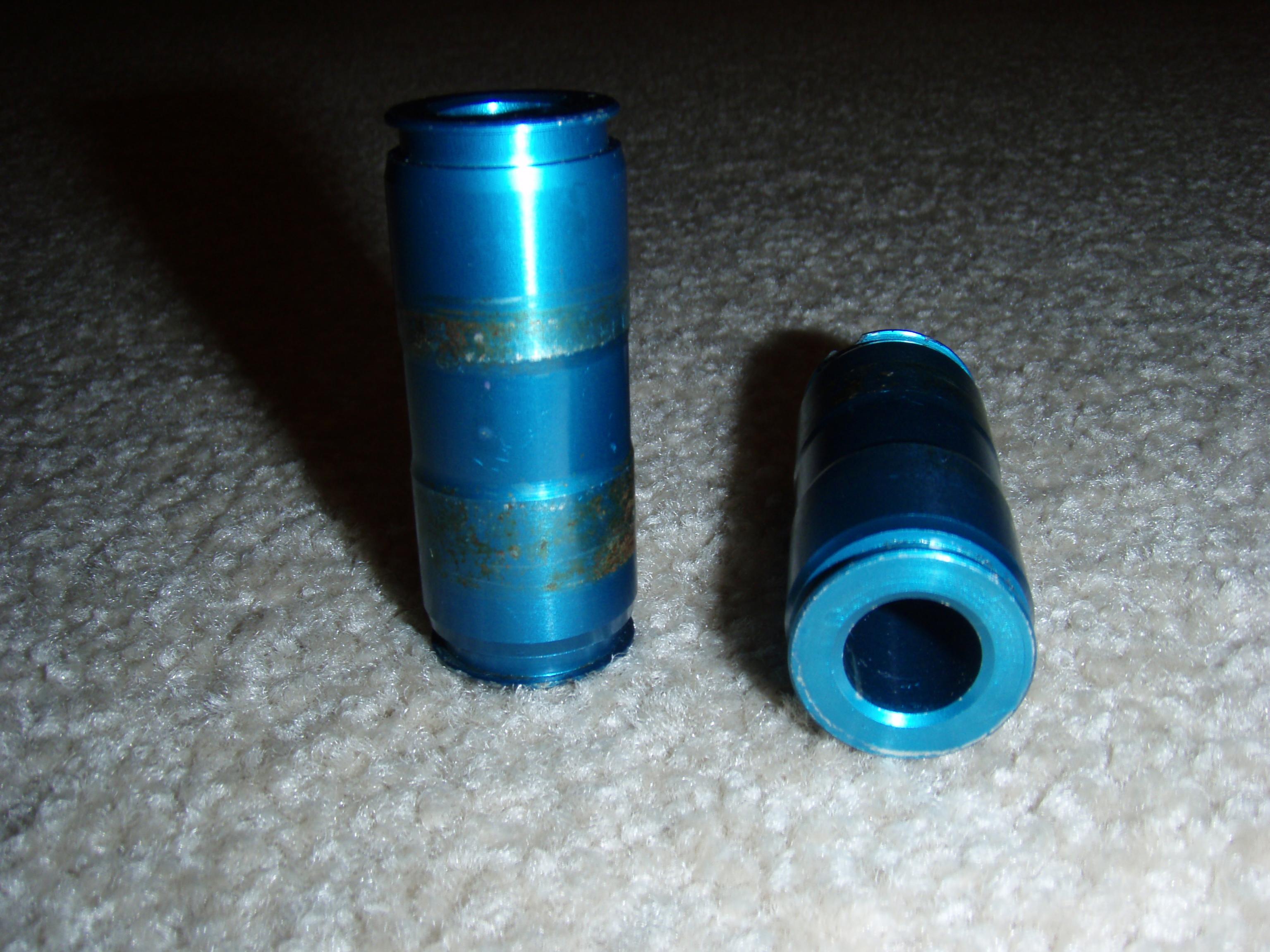

                  I also found aluminum sleeves for the rear calipers on a Lumina Z34. They are much lighter than the steel ones usually found on the rear calipers. I was surprised to find a part like this on a W-body. They are anodized blue that's how I spotted them.

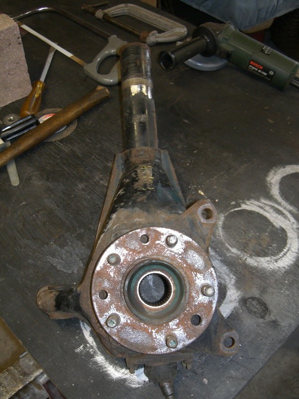

                      Just so we're clear here is the part I'm looking at modifying. This is off the W-body site and not my picture...
                      1991 Pontiac Grand Prix GTP / 3.4 DOHC
                        Yeah, you need that whole assembly from a newer W-Body. Not sure what years, prob 96-97... Either on this site or wbody.com (more likely) there IS a write up on everything that is needed and how to do it. Basically you need everything in your pic plus calipers and rotors from the newer DONOR... I haven't done it,, but I've heard it helps alot....
