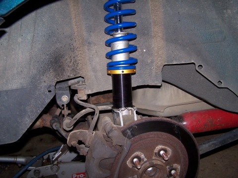

          guy, held motorsports makes gen1 kits, hence the pic. Trust me, save yourself the headache and buy one if you want a coilover kit.
          I have a full coilover kit, below i have a pic of the rear as well as the way my car sits with it installed.
          as far as the noise, about 30 miles after i first put it in, it would squeak. After about 3000 miles, it went away and never came back.
          p.s. the handling difference is insane!

            • #21
              spring rates are whatever you want within reason. i think the highest he can get are either 450 or 500lbs i think.
              my spring rates are 400 front and 300 rear but they are rough on uneven surfaces. On the smooth pavement however they are awesome.
              the basic kit will consist of the mounting hardware, perches, sleeves and springs. you'll have to supply your own struts. he can supply the kyb gr-2's but you can buy them locally and save yourself shipping.
              he also can supply koni adjustable racing shocks but they are very pricey. the rear kit is a direct bolt in but you'll have to modify the front strut assemblies for the front kit. basically all you have to do is cut off the spring perches and a large square bracket if memory serves.
              the site is called www.heldmotorsports.com contact lee and he shoudl be able to do something for you.

                  • #24
                    I installed the Held coil overs in August, so far the only sounds I have gotten from them have been in the extreme cold of this winter. There is a 13 page thread on w-body.com with a complete breakdown of my entire suspension job. Including Held front (350lb springs) and rear (300lb springs) coil overs & kyb gr2s, Held Lateral links and trailing arms, PST rear 7/8" sway bar, front and rear STBs, front sway bar poly bushings, PST front end rebuild kit, MOOG inner tie rod ends.
                    Here is what I did to the front assemblies
                    FWIW, the ride is no harder than before with my blown struts, probably even a little smoother, the cornering is amazing and I'm still running crappy tires.
                    Oh, and my quarter mile time dropped by .3 seconds after the swap to 15.43 @ 88mph, my new best speed is 91mph, so I suspect there is still more left in it.

                      • #26
                        don't quote me on it but it may be 12 or 13 inches. yes the sleeves come with the kit. you gonna get one or what?
                        • #27
                          I think 2 were just shy of 12" and the other 2 were just shy of 11".
                          The white sleeves did come with the Held kit, you have to drill 2 holes in them to hold them onto the stock mount.
                          Mr. E, if you get them I'd be happy to help you with the install, Peterborough isn't far from my parents house in Lindsay. Overall the install took me 7 days to do, but we had some stubborn bolts that delayed everything by a couple days.
