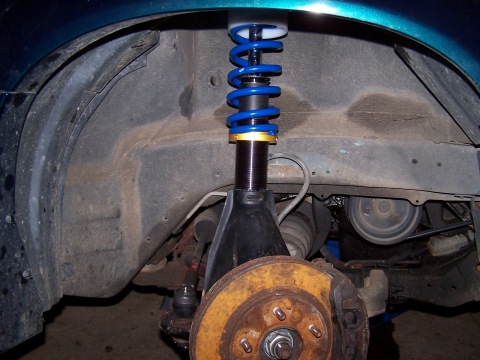

I'm looking at doing two things to my front suspension/brakes but theres one thing im not sure about.
I want coilovers in the front and they only seem to have them for the 95+ cars cause the steering arm is mounted on the spindle and leaves room on the strut for the coilover sleeves, the steering arm is in the way on the pre 95 cars.
I'm also looking at swaping to the 95+ brakes, from my understanding to do this I need the 95+ spindles.
So if I swap to 95+ spindles I have the steering arm on the spindle, so whats really required to move the steering rack to the apropriate location for 95+ steering? I know it can be done cause the W body shell was the same from 89-96.
then once i relocate the steering rack I can buy 95+ struts to get rid of the steering arm on the strut and my coilover probelm is solved![smile](https://www.60degreev6.com/vb5/core/images/smilies/smile.png)
