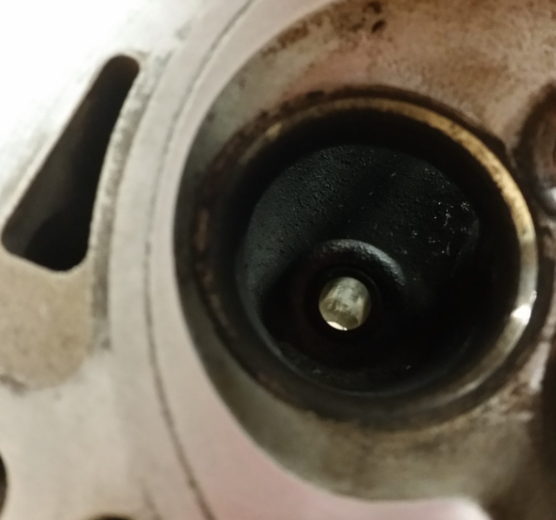

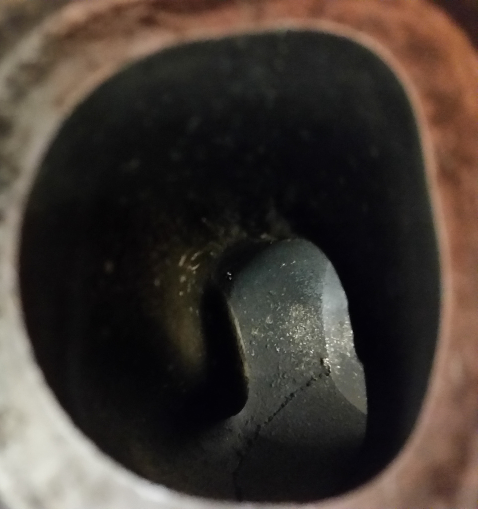

So I did an initial round of cleaning after pulling the valves on one of the cylinder heads. The intake ports are huge but the exhaust not so much. Has anyone put these on a flow bench? I'm imagining the exhaust is a little weaker than ideal. I may try a little porting to remove some of the shelf around the valve stem. Below are pictures of the port:
Any opinions on a valvespring upgrade? This motor will be going into an endurance car so it'll be seeing extended RPM but not huge lift. I'm partially tempted to see if the stock springs are up to it but I've got it apart... Anyone have good or bad things to say about spring buckets?

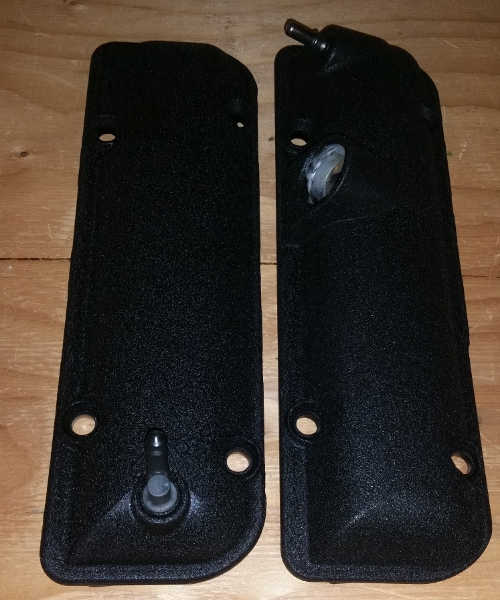

Not a huge update but I am getting somewhere as parts start to trickle in. It always bugged me that GM sent out valve covers with different textures. This time I found an easy way to hide this- wrinkle finish. I'm pretty happy with how they came out.
I'm thinking about a brushed or even polished finish for the manifold. We'll see how fast sanding gets old.
