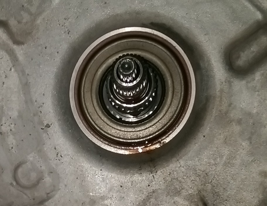

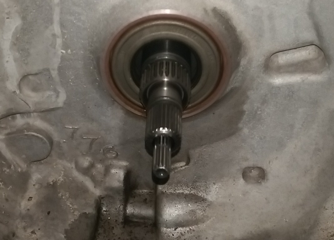

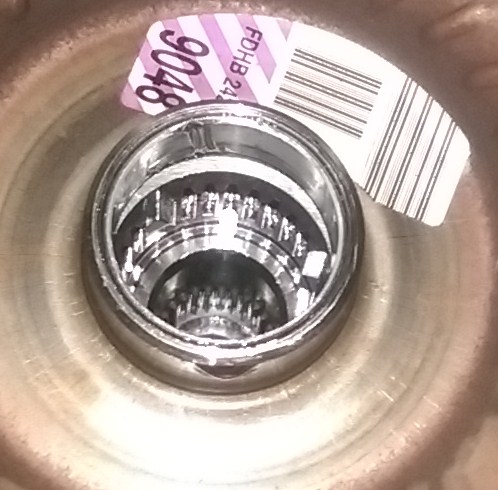

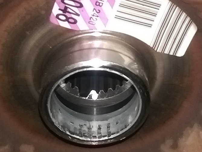

    Without a picture of the damage, I can't tell you much about the torque converter issue.

      Attached photos... I actually had taken a few last month but decided not to post them after looking at them again last night. Not real clear photos. Hope these are better. Also included photos of the splines.
ID:	377970Click image for larger version
ID:	377971Click image for larger version
ID:	377972Click image for larger version
        I don't see anything on the converter that would be horrible. If there is any kind of burr on it, try to smooth it down.
