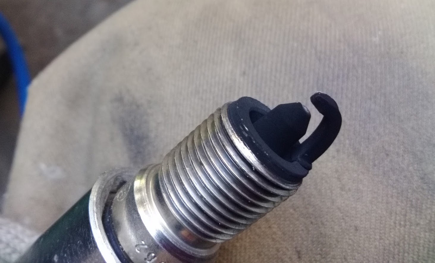

                            And here is the photo of the new sparg plug after several minutes of working

                              Running the stock 2.8 chip with 3400 Multec 1 injectors is going to be rich like the plugs show. How does it run with the WOT-Tech adapter/chip with the stock 3400 injectors and the 2000+ regulator? That might be worth testing.
