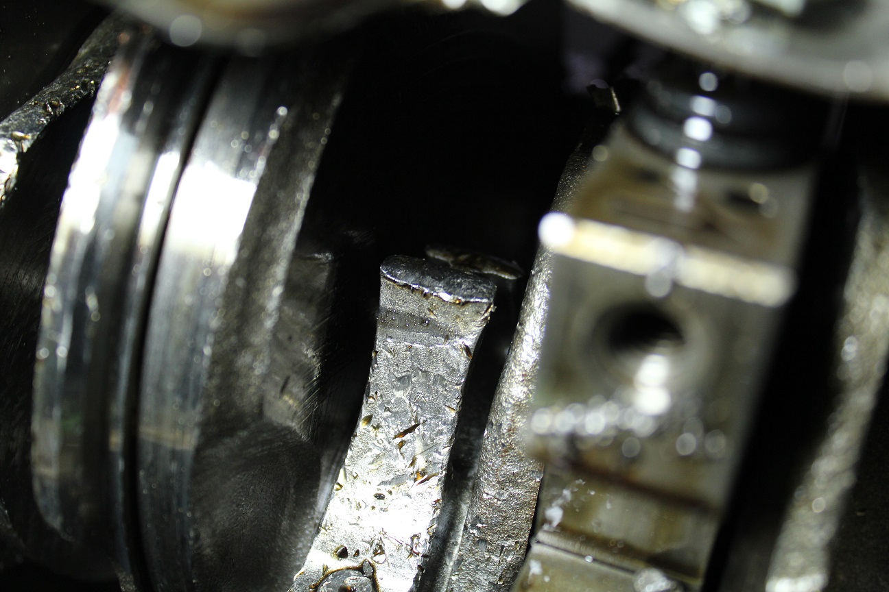

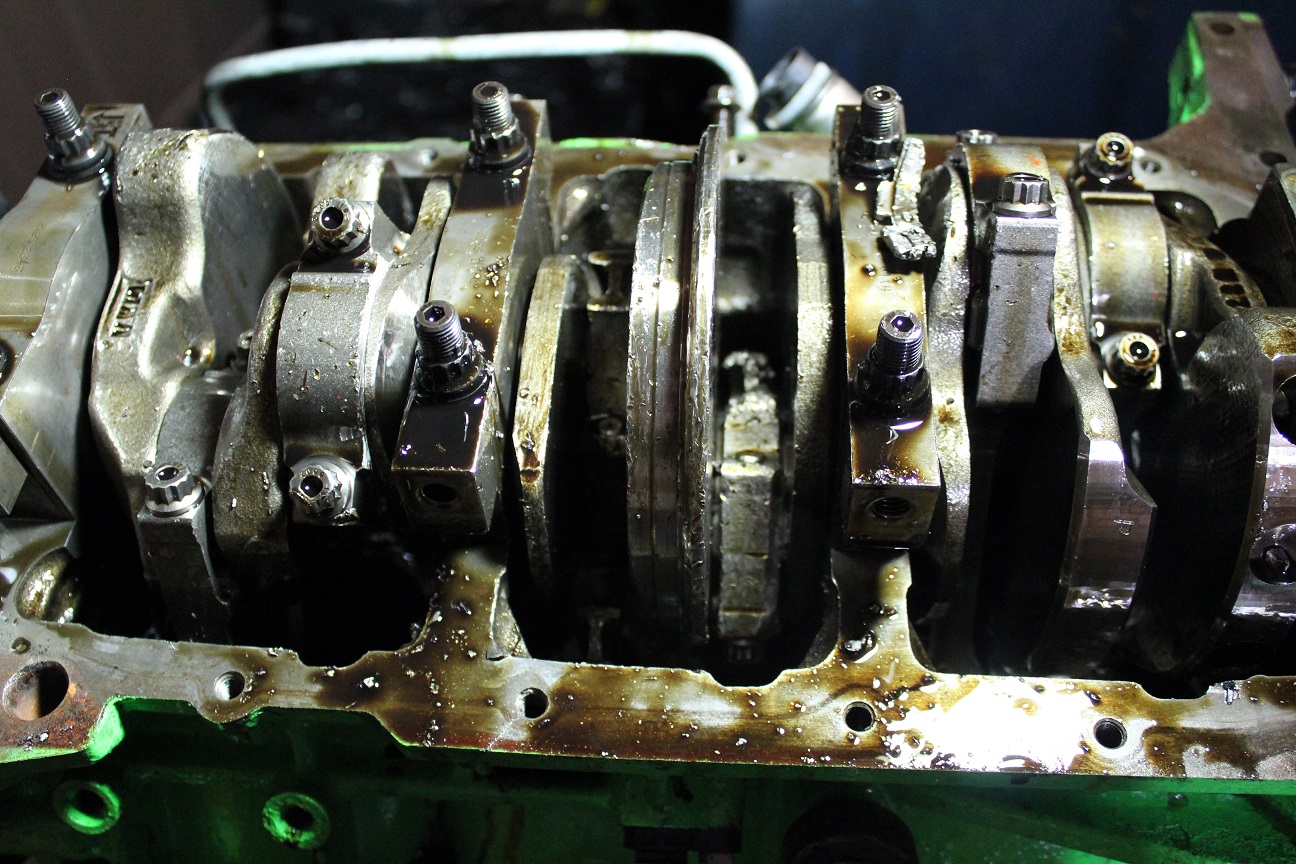

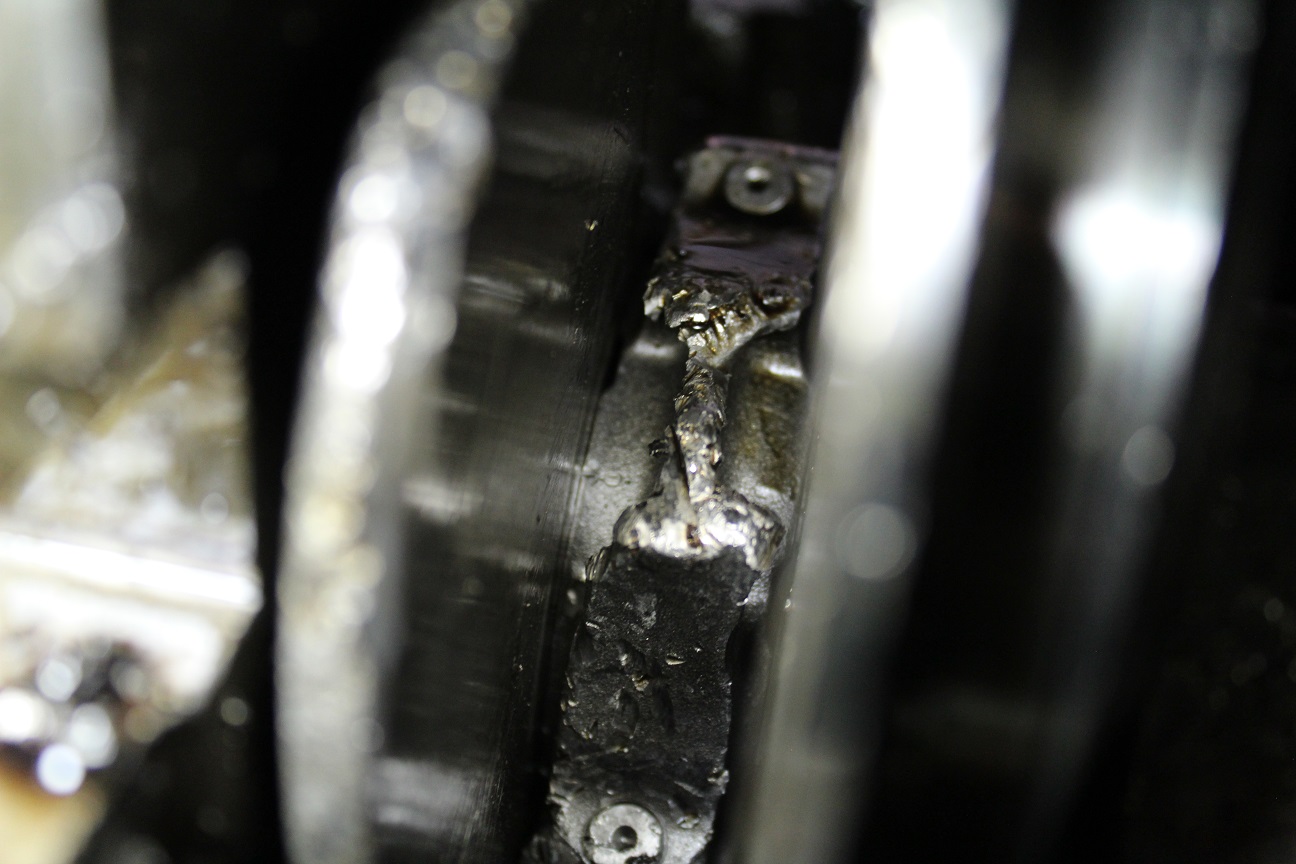

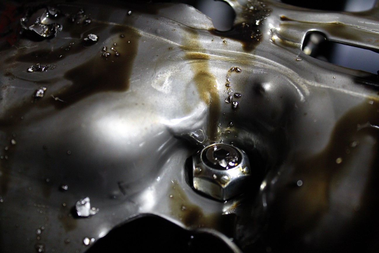

      • More carnage:

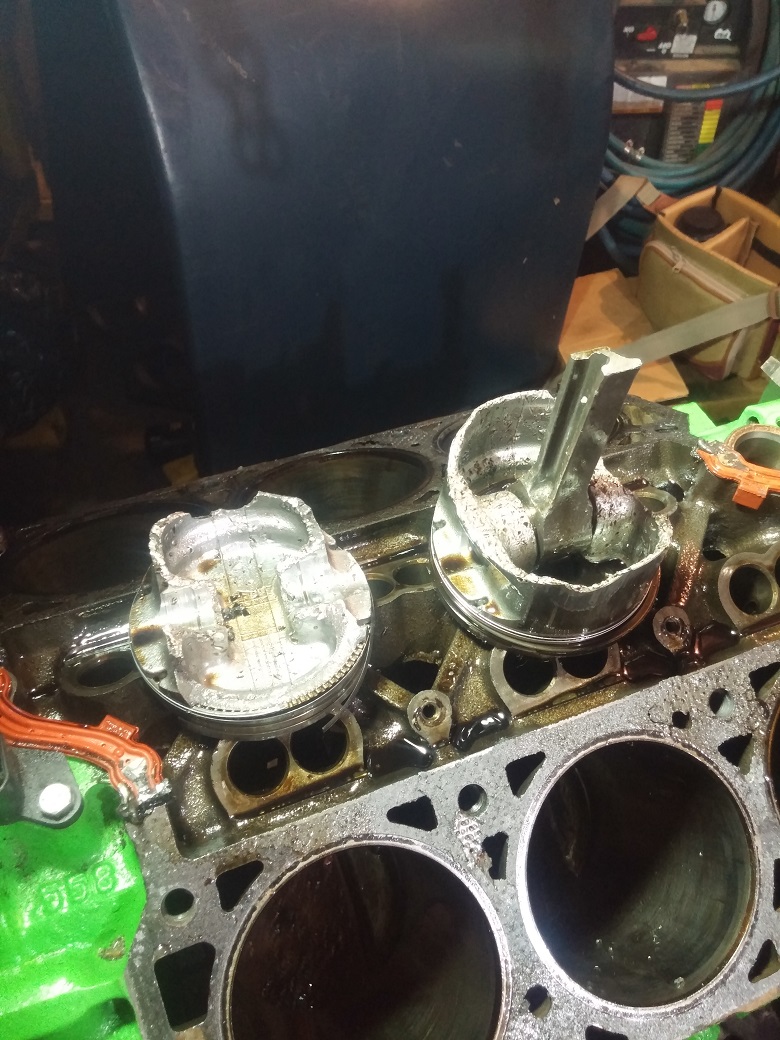

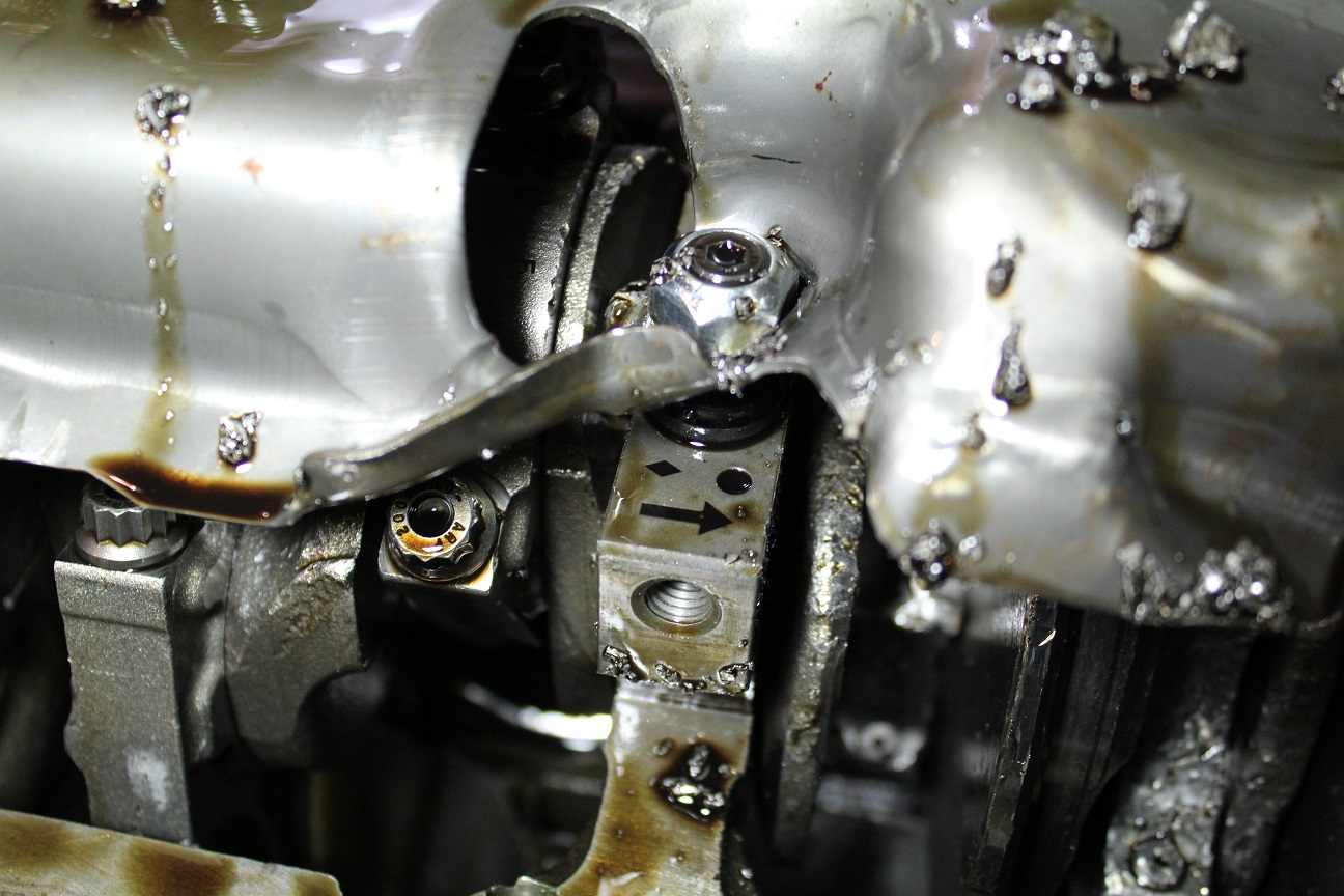

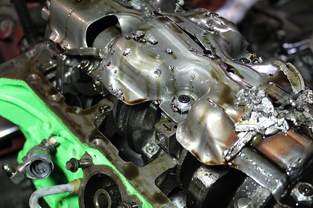

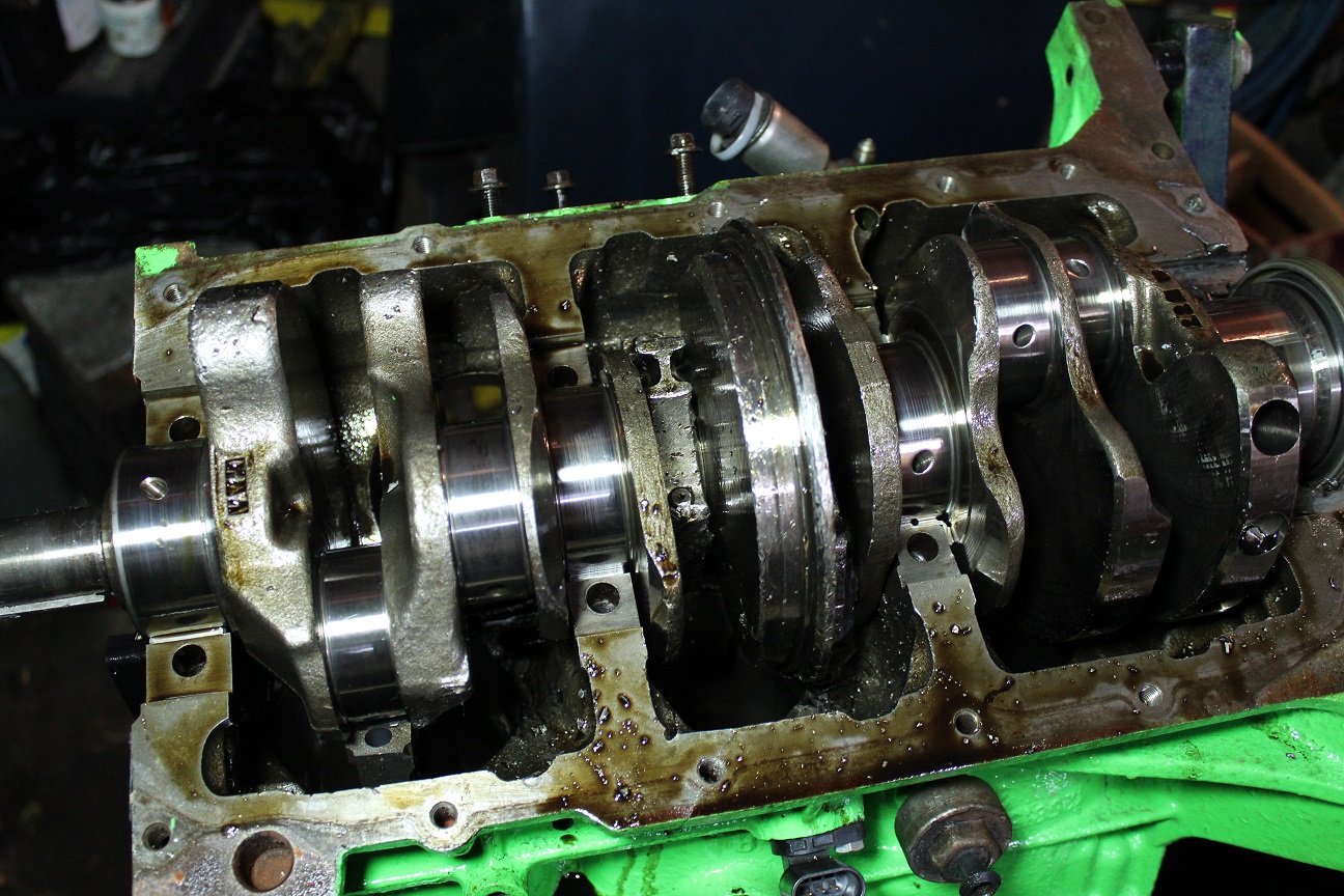

        • Last bit of the carnage:
          #3 on the right and what's left of #4 of the left...
          • I have to pull the data log from my AEM Failsafe gauge to see if there was any sort of spike, but I don't recall there being any at the time.
            I think I've just abused the stock parts for long enough that they decided to give up.
            I believe that #4 let go first, not sure whether it was the skirt or the ring land first, but then there wasn't enough space for piston and rod and extra length under the head so the rod then broke, and that breakage caused lots of debris and took out the #3 rod...
