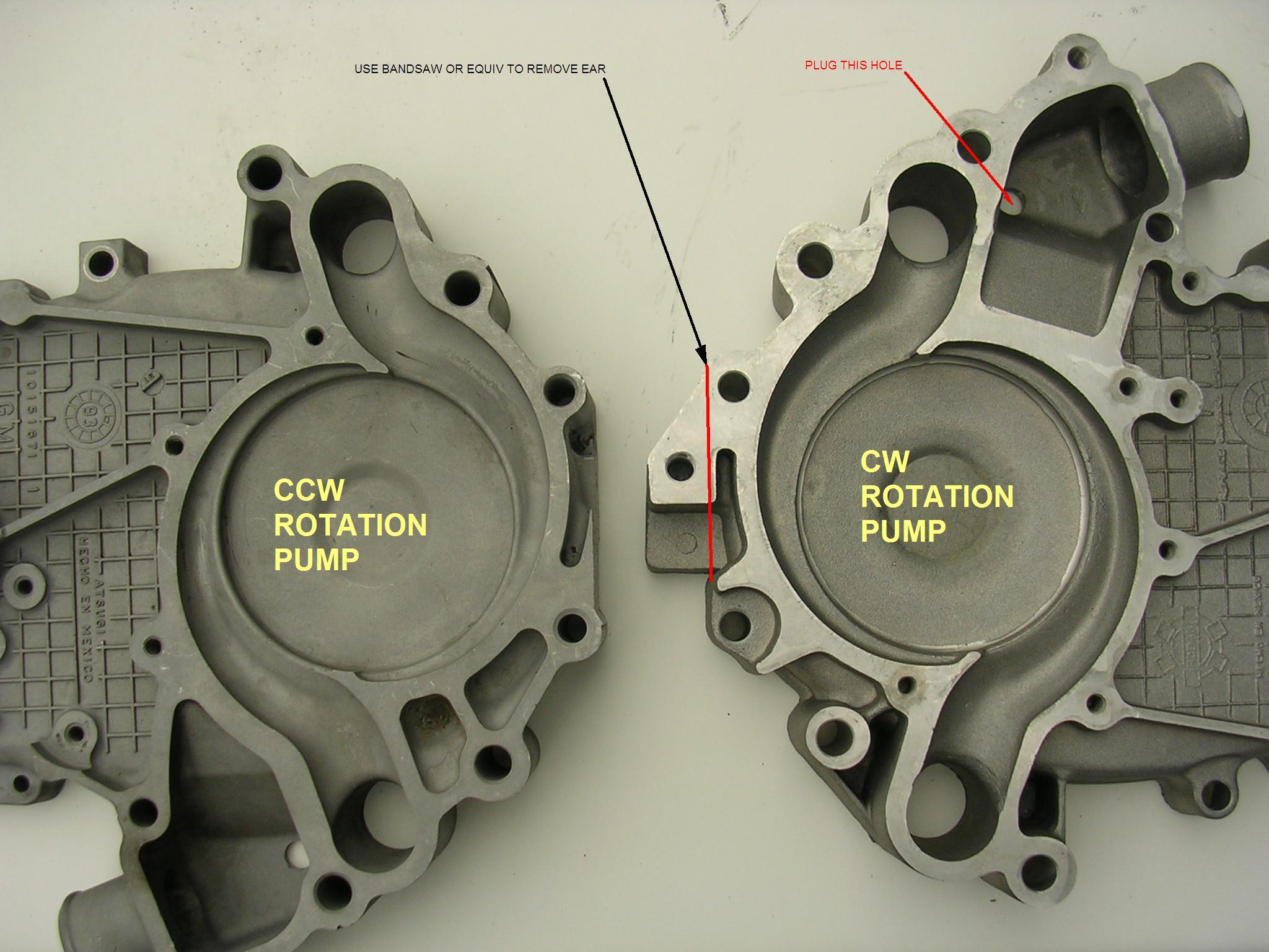

        In the front cover, did you plug the unused hole just below the left coolant port?

          I do have an unused (M6) hole but it does not go through. If it did it would enter the timing chain cover. Is that the one you are talking about? I do have some spare bolts I could put in it. Larry
            Larry... it's a coolant hole that is used on RWD block but missing on the FWD blocks. If you don't plug it, your coolant will pour out. See picture below.

              You saved me great pain and suffering! Should I just put an expansion (freeze) plug in it? Larry
                And why do you cut the top ear off? Larry
                  An expansion plug would probably work fine. I usually weld a plug in the hole.
                  Cutting the top ear off will let you rotate the lower intake 180 degrees so the T-stat is in the front for RWD applications.
