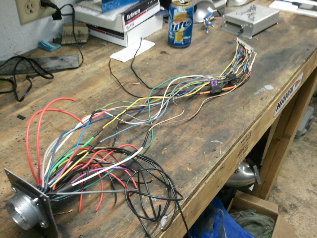

little update... ive been sorting out most of the wiring in the car, making megasquirt/msd harness, body harnesses etc..decided to go with bulkhead connectors everywhere. all of the connectors were free (buddy discount), i want it to look right, plus added room in the harness and being able to be disconnected whenever is nice. once the wiring is sorted i can install the rest of the engine bay, then put the bumper on and wire the headlamps etc.

More wiring...sucks but it has to get done. engine harness made up fully even though im waiting on more loom. megasquirt and msd body side harness is being made now. also got the ceramice coated headers wrapped up and installed. more updates soon, thanks for the support :up:
