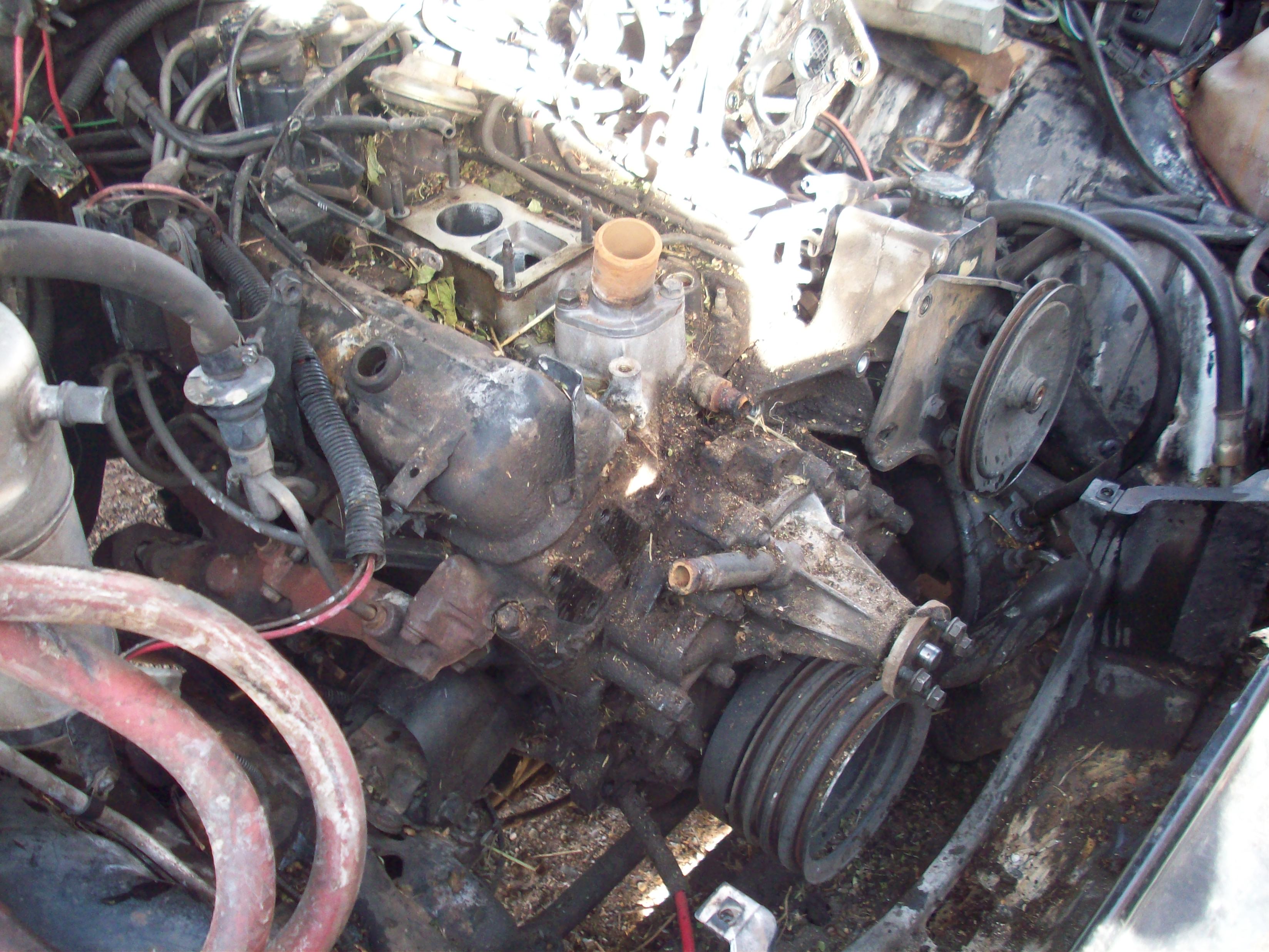

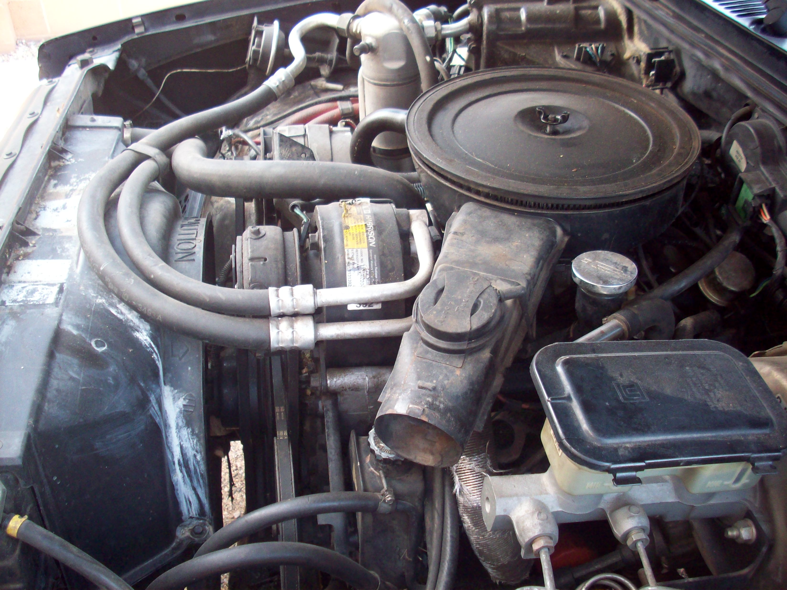

                        I got started tearing down my motor for the engine pull. Here are some pictures.
ID:	376444Click image for larger version
                        84' S-10 Blazer http://axelsmancave.blogspot.com
