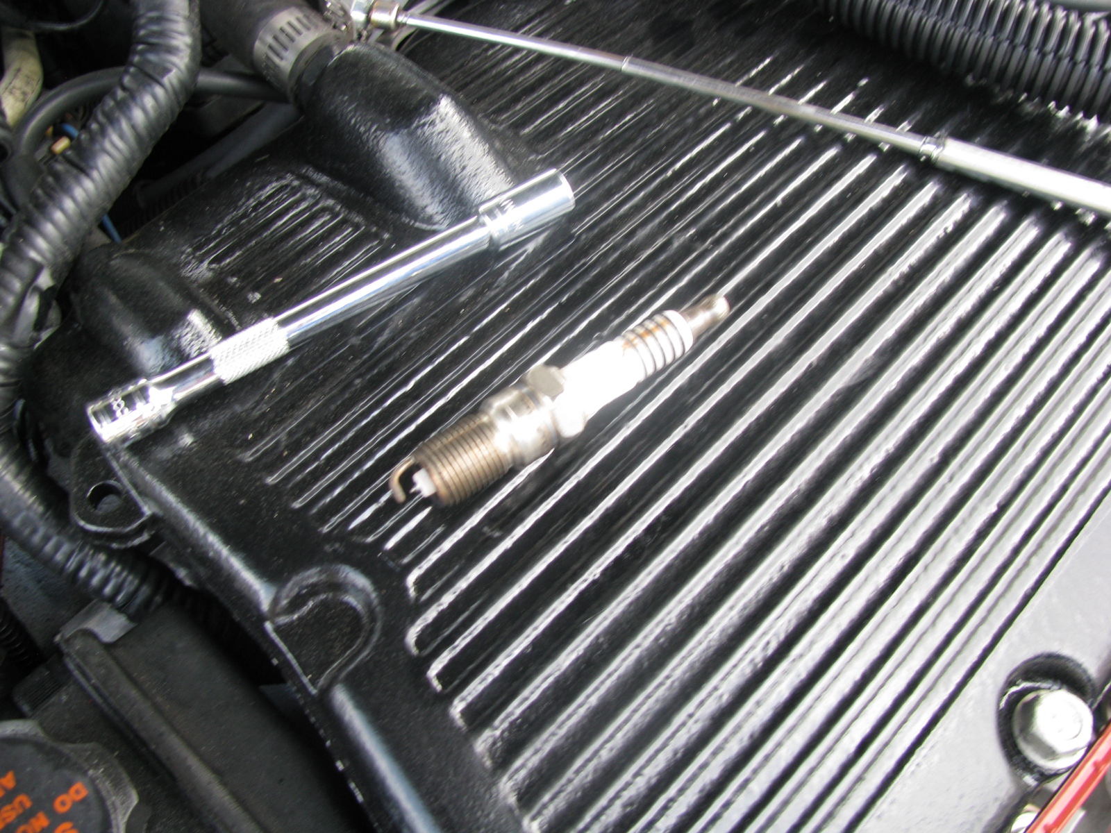

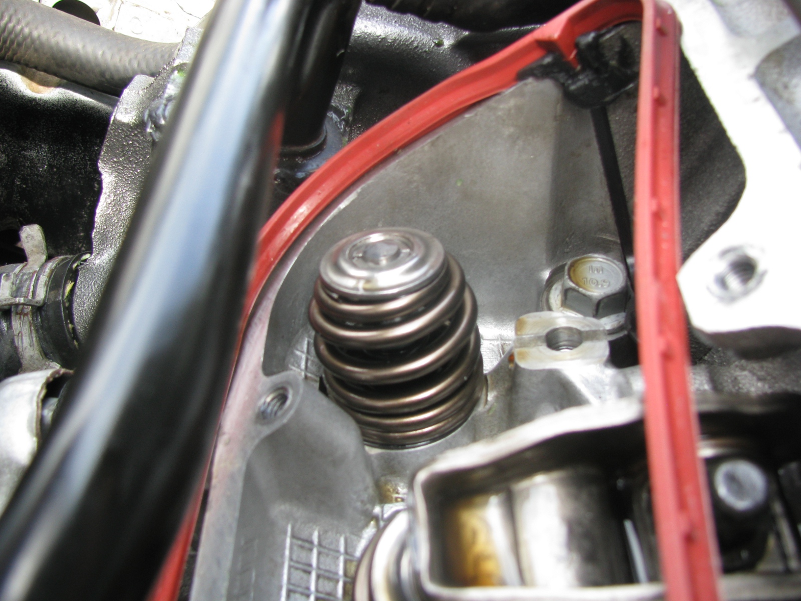

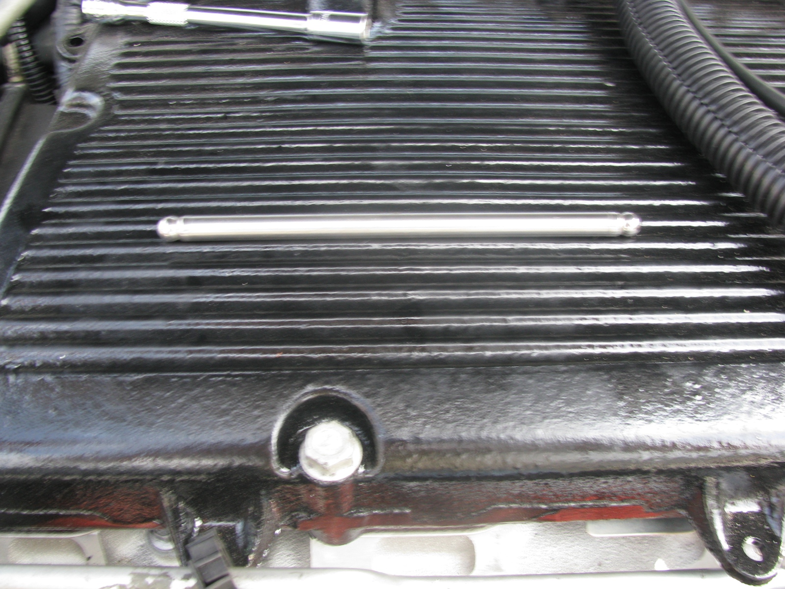

                            All the exhaust valves hit the pistons while the intake didn't. We triple check that the pushrods were installed exhaust being the longer and
                            intake shorter.
                            The pushrods don't look bent at all. The spark plugs were perfect. Just stuck valves on all the exhaust. The intake didn't hit and
                            looked fine.
