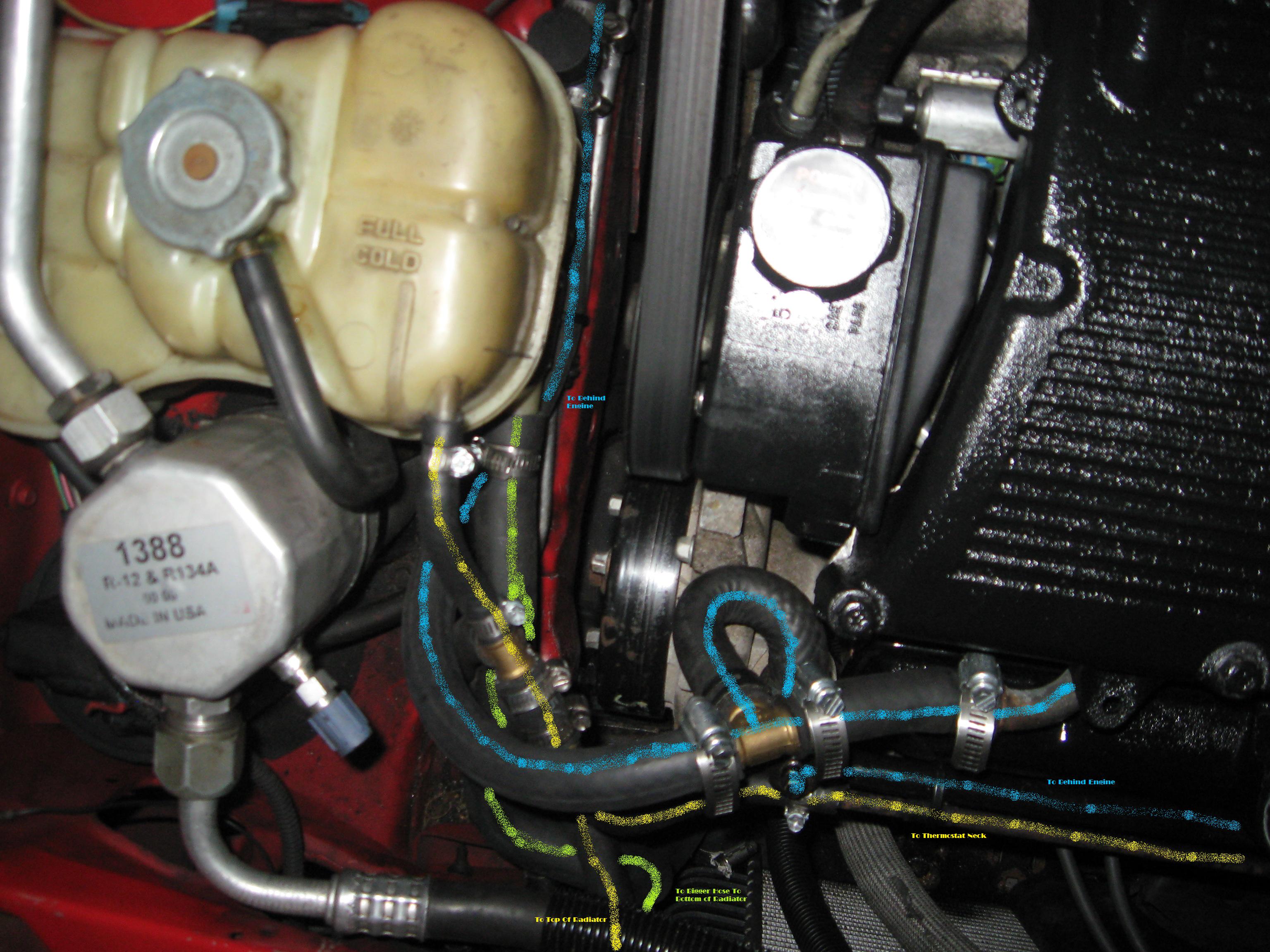

    I am trying to double check to see if the routing of my coolant lines is correct. I looked at diagrams and ended up with this. The engine is from a 2006 malibu, 3.5 non vvt and is in a 1990 cavalier z24 that had a 3.1. How does it look? Thanks
