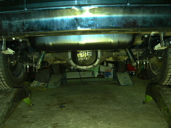

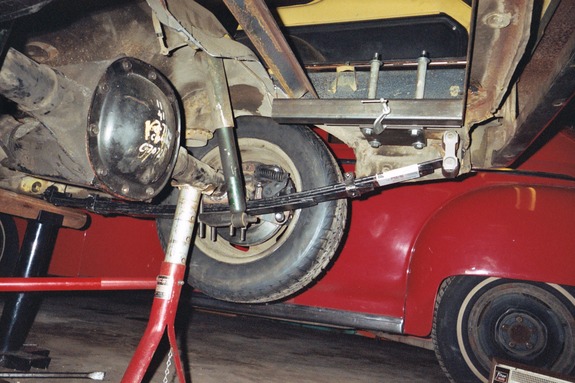

I'm in the process of putting a 2.8 V6 & NWC T5 in my 79 Chevette 2dr. I started by installing an 84 S10 3:73 Posi Rear Axle, a Parallel Leaf Spring Rear Suspension, and a 15 Gallon Jeep Scrambler Fuel Tank. You can check it all out at www.cardomain.com/ride/511840/2Last edited by BUTRNUT79; 03-20-2010, 08:06 PM.
1st off, I wanted to tell you i love your car! I've always liked chevettes.You've got great info on the motor swap. I really like the revelation with the oil pan. I'm getting all my ducks in a row for a 60/V6 conversion once the 4-cyl turbo goes. Did you use an '85-'88 2.8? I hope you didn't use the '84 and under. As far as your engine build goes, I think you will be very pleased with the end result. I did a similar set-up using a '92 3.1 out of a wrecked firebird back in'94. I put a cam, 4v, and hung headers on it...stabbed it back in my '84 camaro with a 5-speed and 3.73's. The car ran REALLY good for a v6.

Glad you like my ride...compliments are always welcome. I've been planning and collecting parts for "BUTRNUT" for about 5 or 6 years now and it will probably be another couple of years before it's on the road because I'm taking my own sweet time getting it done. As for my engine... I have an NOS 1985 2.8 V6 Shortblock , with 9:1 Pistons and the One Piece Rear Main Seal. I got it got from a guy in Michigan who was selling them on E-Bay. He had 100 NOS 2.8 V6 Shortblocks that he bought from GM Surplus.
