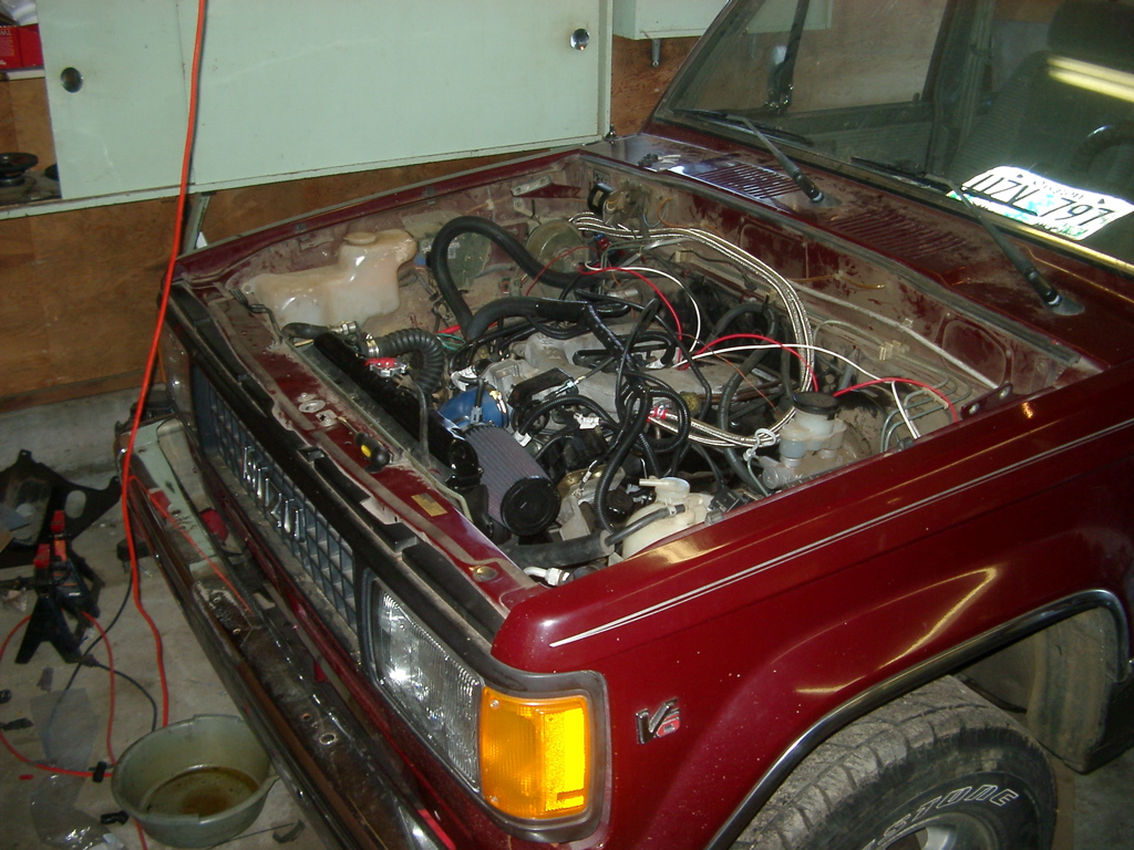

Hi everyone I have a 1989 Isuzu trooper with the 2.8 TBI engine in it.I paid $200 for it knowing it had a blown intake gasket
The engine runs great with 210,000 miles ( which at 209,000 freshened it up with everything other than rings and bearings) so you ask why swap???
Well the Trooper came with 4.56 gears from the factory with that being said at 70mph on the interstate it's doing 3200rpms and at 55mph it's at 2500rpms.
So if I ride the interstate I only get 12mpg per gallon and off the interstate 17mpg and thats shifting at 2000rpms everytime.
SO I want to put a set of 33" tires on it to bring the RPMs down,but I know the 2.8 want have enough power to handle them I will be using 4th gear to much.
So my plan is not to use L32 3400 oh no i'm going with the LA1 3400.
Reasons why I chose the LA1 is,,,,
1st,,, 185hp and 210tq
2nd,,,the starter is on the correct side for my trooper.
3rd,,, I can use the 2.8 distributer and most of the sensors are close to the same location as the 2.8 so want have to do to much wire harness work.
4th,,,I should be able to use the 2.8 exhaust manifolds
5th,,, This i'm sure is going to make you ask why????,but I am NOT going to use the LA1 fuel system nope to much $$$ and work.I am going to smooth out the center section of the LA1 upper intake and mount a 4.3 TBI throttle body on it.And make a block off plate for the 3400 factory throttle body location( I really thought crazy
) about putting two 2.8 TBI throttle bodies on top of it,but I need to see how good the one 4.3 TBI does.
So this Sunday i'm going to pick up my LA1 3400 that was in a 1996 Chevrolet Lumina APV.
I don't think motor mounts will be much problem because my mounts are at the front of the engine on the chasis.
The only thing i'm not sure about is the accessories it would be nice to be able to make my factory accessories brakets work,but i'm pretty sure the LA1 water pump location will screw that up for me. So only time will tell.
Last,but not least your probly wonder why put this much time and money into something I only paid $200 dallors for??
Well the answer is it has a huge amount of room plus the windows are so big it feels like riding in a Bluebird bus and my 3 year old son can see everything because of the big windows. Plus for what ever reason I have grown an attachment to it.
Well people if you have any suggestions or things i'm not thinking about that my be an issue please let me know any help will be grateful.
I will update yall with pics of the progress if yall would like.
Wish me luck
Cliff
