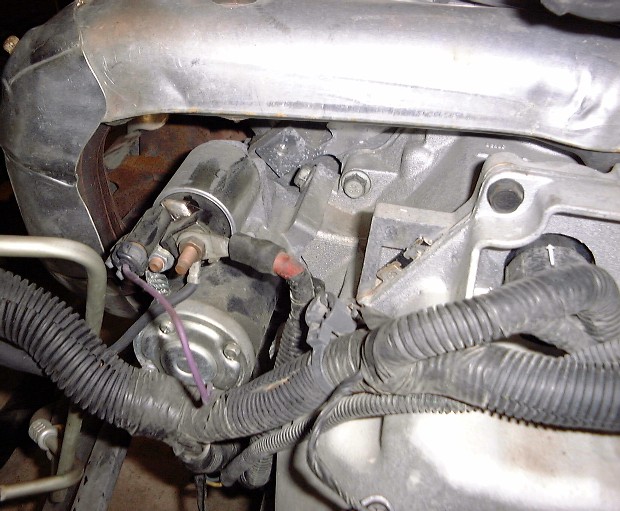

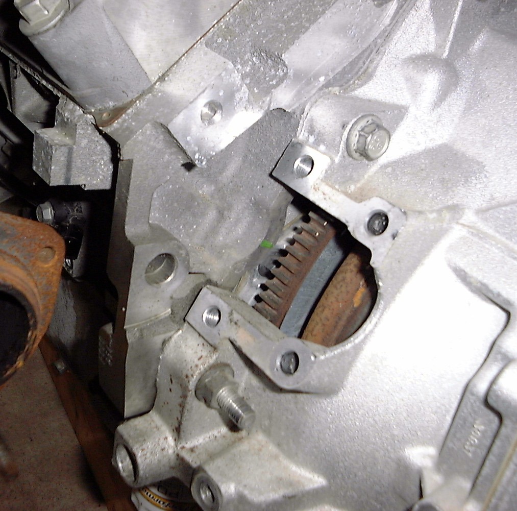

                Not so fast. The starter mounts in the 10 o'clock position to the transmission, not the block...
                Might make things a bit difficult...

                      I'm sure by the time i'd actually get to this swap we'd have it figured out... not gonna happen till atleast '09 if i still have the car then. Besides, i'm making more power with my 3500 then that thing has.
                        It occurs to me that is would be a good candidate for a rear engined swap. Kennedy Engineering has adapters to mate a 60 degree V6 to a VW, Porsche or Corvair transaxle. The starter bolts to the transmission and the engine is pretty lightweight. Just thinking…
