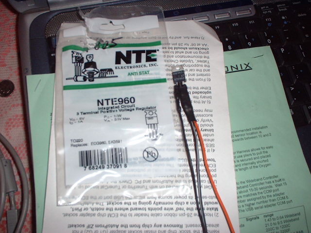

    I'm having a bit of trouble with the alternator. I installed a little 5v regulator today and it appeared the voltage went up a bit more over 13v but later on it started registering in the 12 v range on the datalog. I'm not sure if I damaged the alternator with the 12v feed or if the regulator is not carrying enough amperage which I doubt. I'll have to take it and have the system checked.

    STILL COULD USE SOME INPUT ON THE ALTERNATOR ISSUE.

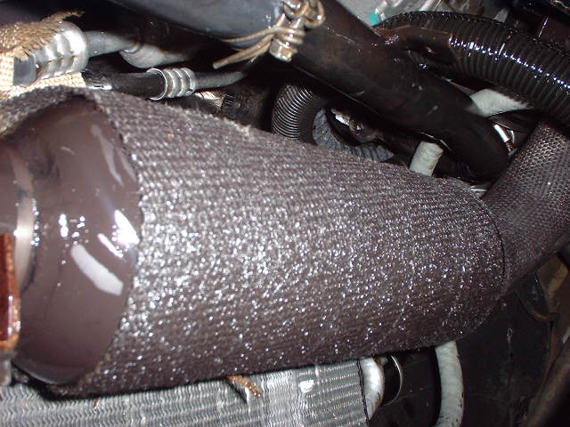

                      I have to take a moment to bring attention to the fact that the stock compression for this engine is 9.8:1. There have been many debates and arguments about needing to run low compression with turbos here in the past. You should run as high a compression as the boost level you intend to run will allow. In my case once water injection is installed 14 psi with pump gas should not be a problem.
                      There is also a possibility the oil jets for the pistons are helping also because oil temps are running on what to me is the high side at just over 220 suggesting additional heat being absorbed from the pistons, at some point I'll get more air to the oil cooler.

                          So far it appears the stock TGP code can be pumped up a little, it was also designed for an automatic and there was an area in the table with considerable timing reduction and I'm sure gear ratios had something to do with that.
                          I believe the oil temps are kind of high because of the heat it absorbs from the pistons, the cooler is not in the most optimal location and it is getting some heat from one of the mufflers which will get a good bit more heat wrap than the one layer it has to eliminate that. Later I'll invest in some mufflers that will fit in the tail pipe location so I'll have room to add a fan to the cooler. There is an additional cooler that uses coolant at the oil filter so if I can get oil temps down around 175 that will be a big plus.
