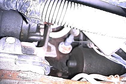

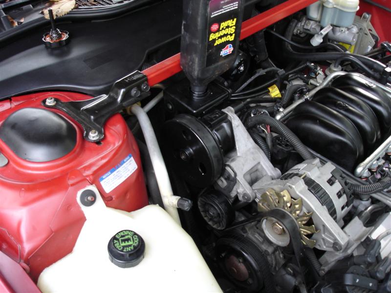

                    And you're correct about the L27/LQ1 mount being in the same spot on 1st gens. Now there isn't a mount in that spot in that generation H body. Although the 1st gen H body DID have use a mount in that spot and GM kept the provisions for that mount on 2nd gen H bodies. So you may be able to use the LQ1 engine mount. And you're correct about N bodies having the torque axis mount. My dad's 94 Corsica has one as well. I actually would try that route first. I would not recommend putting a dogbone on the radiator support. It isn't NEARLY as strong as W Bodies. That is, unless you reinforce it.
                    I included pictures of an H-body torque axis mount (you can kind of see it), The L27 engine mount in a W-body, and a Picture showing the area where the C260/P102 is located, and pictures of a 94 3800 Memcal.
                    -Sean
