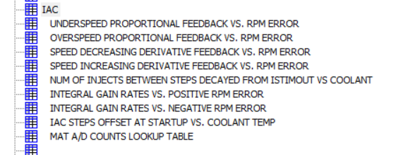

                        I am looking into the IAC adjustments, however I have no idea how to fix these.
                        What are each of the settings in the photo I attached, and how do I understand hwo to adjust these to fix my stalling engine at idle in both open and closed loop?

                          Don't worry about making any IAC adjustments, those are for advanced tuners that know exactly what they are doing and AFTER the engine runs decently. Most of the time those settings NEVER need touched.

                            I smoothed out the boost, the origional TGP code at any throttle enough to build boost, would build up to my max setting in PSI (About 13 PSI) right away, even at part throttle, and it was horrible because it caused hard shifting and sometimes confused the transmission.
                            I adjusted it so the PSI of the turbo is somewhat proportional to the engine, although it builds boost right away, a normal 1/4 to 1/3 acceleration will no longer cause me to have my 13 PSI right away, it builds and sits about 5-10 PSI, higher or lower depending on throttle.
                            At WOT, it goes full 13-14 PSI and it really hauls down the road. I estimate my 0-60 to be about 5-6 seconds at the most.
                            I still do not have the TCC working, I can't seem to figure this out...
                            However I can tell there is room for overall improvement, my spark is not ideal, my fuel is on the rich side.
                            Its finally good enough to drive without needing a tune immediately, and that is good because the only place near me willing to look into tuning my car doesn't know if they can do it successfully.
                            If anyone here knows of someone who can provide me with a refined tune for my car, That would be awesome.
                            I did find a guy who says he tuned over 300 TGP's, but I don't know if he still does it.
                            I attached my tune to this post.
                            If anyone wants to look at it and let me know how I can improve or fix it further, that would be awesome!
                            Aside from that, I am probably done for a while until a professional tune can be done, the only reason I might try this again is to attempt to make the TCC operational, but I don't know where the settings for the input/output control is.
                              if you were to post a log file(XDL), that would be helpful, so other people could see what you're seeing.
