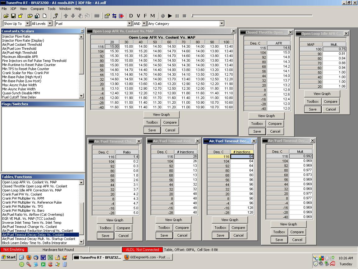

    I've attached the factory tables, so you know what to look for. Notice the A/F timeout table that has you at -3.1 AFR even at a 44*C warm startup! That seems a tad ridiculous to me.

          but here's my open loop AFR setup... works well for the GP.
          EDIT: now with all of the Choke tables...
          DOUBLE EDIT: apparently PNGs get resized and saved as JPGs.... TIFs work though.

                  i haven't seen half of those tables. choke, decay rate, injector pulses? what .xdf are you using?
                  discostu...did you ever end up with the full version of the A1 .xdf file?

                    my newest A1 XDF is on the tunerpro website... it's very damn complete if you ask me. i just left out some co-efficient stuff...
                      i just see a listing of everything. what if i wanted to use that file in tunerpro?
