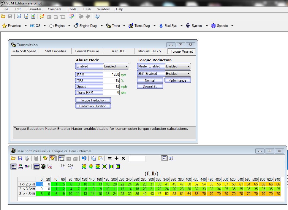

The biggest issue I've noticed with it, it will go into abuse mode. Not sure what I need to disable/change to stop it from doing that. It does this randomly. I'm not burning out or hot rodding around when it happens. I haven't really beat on it yet. Want to get the water pump changed first. It's eating the belt and squels really loud. It also runs a bit hotter in town (max so far is 210F so not exactly hot but I believe it should stay around 199-205F) so I've only been using it to commute to work (roughly 8miles round trip.)
Last thing, any suggestions for increasing the transmission pressure? dos and don't/s?
