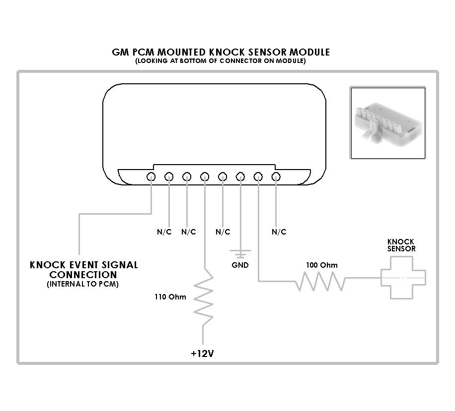

    Seeing that gave me the idea of trying to use the removable knock module that is mounted inside my PCM under the little cover. The only problem is that I had no idea what the pin-out on the connector was or if it can even be used in the same way as that megasquirt writeup. I took my PCM apart and tried to map out where the traces were going on the boards in the PCM from the knock module connector. I think I was able to map it all out. I've made up a little diagram for what I think I found.
    Does anyone know enough about these modules to verify this? I seemed to be able to trace all of the resistances I was reading to actual physical resistors on the board. The 100ohm resistor was a little surface mount guy and the 110ohm one was a large power resistor that looked like it fed a bunch of other electronics coming directly from the +12 input for the entire PCM.
    Let me know what you think. I'd like to try and connect the knock module in my PCM to the megasquirt to get a more acurate knock sensing set up since the module should be tuned for my engine and knock sensor.

      Am I going have to be the first person that tries it? I could just get a module, wire it up like the diagram and look at the output on a scope.
      I would prefer to find a cheap knock module somewhere to test with though in case I burn it up.
