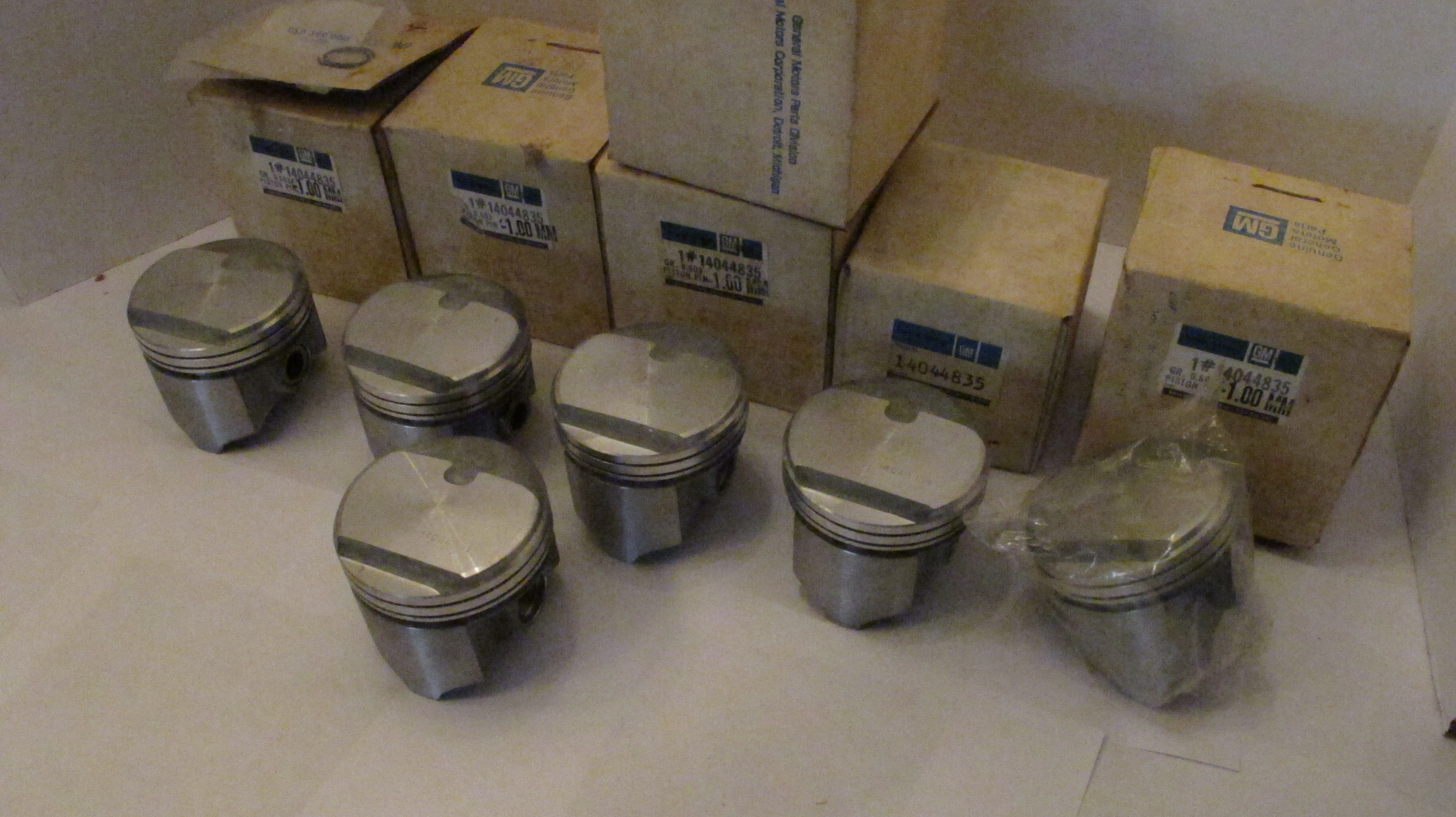

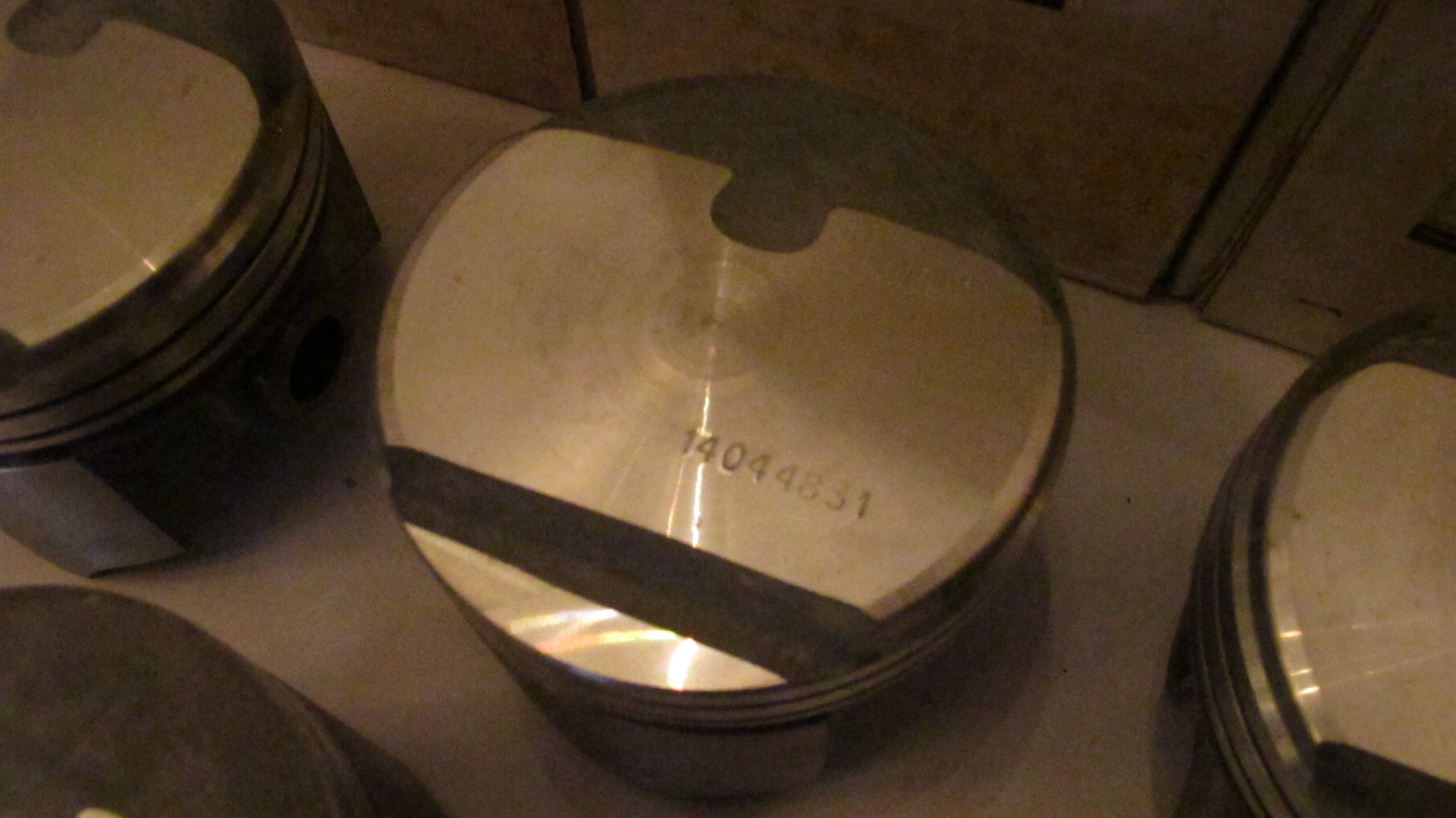

that shows them being specified for the 2.8 w/1.0mm overbore.
EDIT: it also specifies to be used with gen1 heads only?
if you have e85 in your area, then I would find a 3100 block for the roller cam only, 2.8 crank, these high compression pistons, port out some iron heads, and pick up a iron head itb that stalkerv6 is about to put up for sale on here. 250 hp should be doable with that setup.
