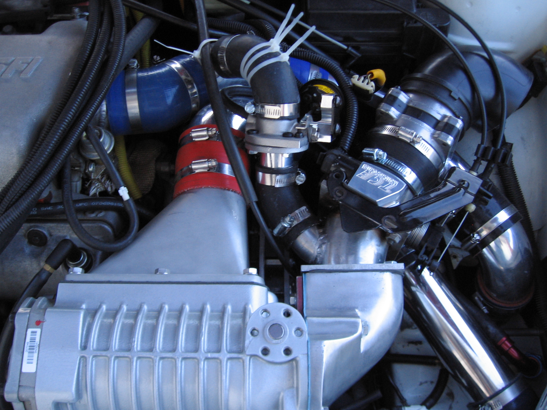

                To clarify, this setup requires the battery to be relocated. The components are currently located as shown:
                Although I have an AW intercooler installed in the fender, the first attempt to use it with the MP 90 did not work. The method and location of the bypass system could not properly react to the pressure changes.
