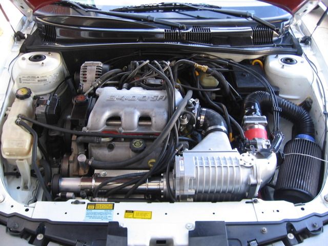

1st Mock-up Complete!
Got in some test drives today, after much test fitting for the belt system.
Hit 8 psi with the stock TB and MAF, and the cheap CAI tubing. Leaving a lot on the table, there, lol
The exhaust is 3 inch, CAT+ Muffler.
No, I didn't notch out the hood brace like I said to, and yes it did knock a little paint off the blower case, But it worked!
As expected, the 90 degree silicone coupler collapses under vacuum, so it needs reinforcement. So now I can refine the prototype parts as I go along, upgrade the TB, etc., and we'll see how everything holds up with some abuse.
