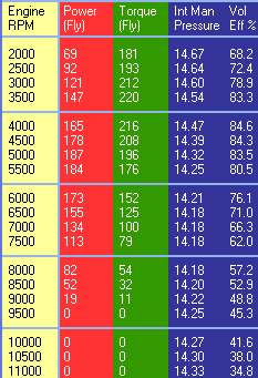

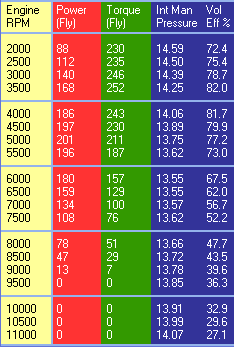

            When calculating airflow for maps plotting... what VE% do you knowledgeable fellers use for a 3400 or 3500? The often suggested 2 valve 85% just seems a bit low to me...
            - Ben
            • #21
              stock 3400 and stock 3500...
              not calling these perfect, but they are what i use.
