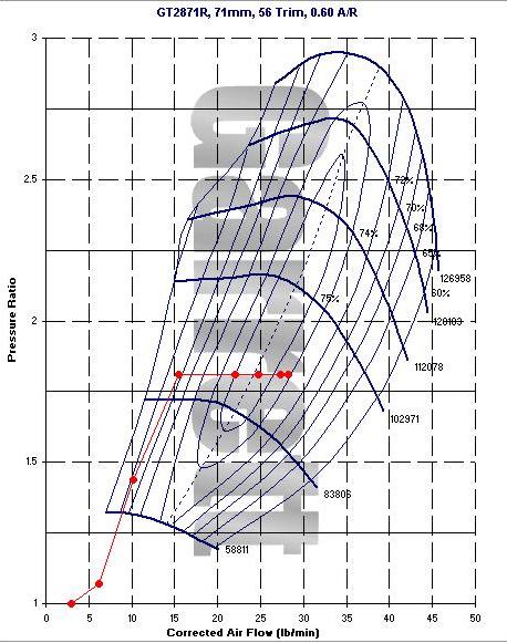

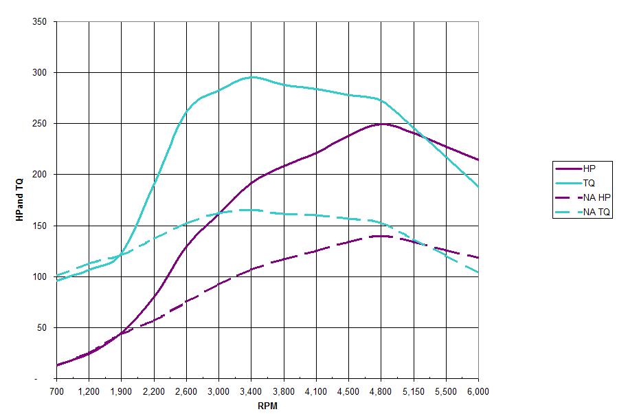

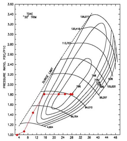

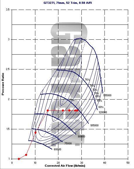

Getting ready to order the turbo for a 3.1 iron head motor. Based on my research, it looks like a GT2871-743347-2 will be well matched to the amount of boost I plan to run. I'm trying to figure out what turbine A/R ratio to order.
The engine is going in an '85 Fiero w/Muncie 4-speed. Realistically, this vehicle will only be used for cruising around, and maybe the odd auto cross, so it will be living in the 2500 to 5500 rpm range with redline @6000.
Engine Specs
.75mm overbore 3.1
Sealed Power iron head hypereutetic pistons (expect ~8.8:1 CR after polishing combustion chambers)
Crane 2030 cam
1.6 roller tip rockers
head work limited to gasket match and bowl blend and general clean-up
Stainless steel valves
105# valve springs @ 1.7 inch installed height
Ported LIM (custom UIM being researched - I want to use the Sy/Ty TB)
W2A intercooler from Sy/Ty
7749 ecm, going to try to make $59 work on a 60V6 with DIS
Depending on how the tuning goes, I want to shoot for 12 pounds of boost.
Compressor specs:
71mm
56 trim
.6 A/R
I have to decide between a .64 A/R and .86 A/R turbine housing. I'm leaning towards the smaller A/R housing as it will allow the turbo to spool quicker, and provide boost closer to the bottom end of the expected rev range.
Will this housing be too restrictive to exhaust flow at higher RPM?
