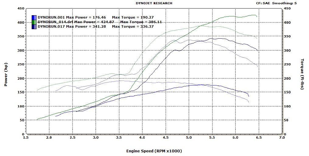

Be careful with the T61... There is an older T61 that really isn't an impressive turbo. The newer T61's use the GT35R compressor wheel with an older style T3 or T4 turbine. Those T61's that use the GT35R compressor wheel are a GREAT match for the engine. That would work really well and be cheaper than a GT35R.
Good T61 with T3 and T4 turbines (Honda-Tech sometimes has them cheaper from sponsors)
Good 60-1 combos in T3 and T4
BAD T61
There are two problems with this turbo. 1. These turbos are never what they claim to be and give lots of specs that don't match. 2. The reliability on no-name e-bay turbos is very sketchy.
