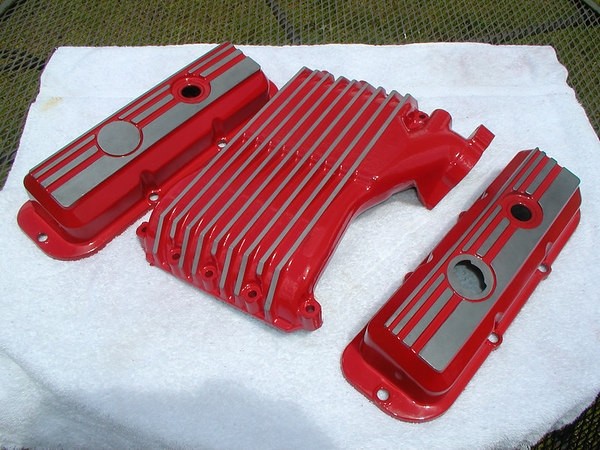

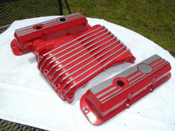

helping to test the new sites little things, like pic uploads and display, here are some pics of kevins handi-work, the finished parts i sent him for powder coating:

Looks good. Looks factory, like the fiero or sunbird 2.0 turbo style.

hmm... so how much would the total cost be for a 3.4TDC intake plenum powdercoated red on the runners and left silver between the grooves, and also with a "z34" graphic on the center or so? (no fancy font, just block letters) the zip code for shipping is 60429
Send me a picture of the intake and I'll let ya know.
