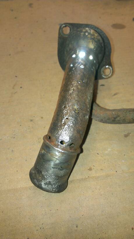

    This is proof even green coolant can eat stuff if not cared for correctly.
    This is the coolant neck the thermostat for my truck goes in on the front of the engine.
    Note, when I got the truck it had 170k on it and the coolant was a nasty nasty brown, so I figure means it was original...
    Side note, you can't see it, but the reason you see light from it at the top of the pic is I have my 3 watt single LED flashlight in there.

              I'm confused... it looks like that rusted externally more than internally... The exterior of that pipe is not smooth it's pitted badly.
              Either way you should always use distilled water in conjunction with your coolant of choice, that will eliminate the chance of any crap buildup.
                The inside is just as impressive as the outside.
