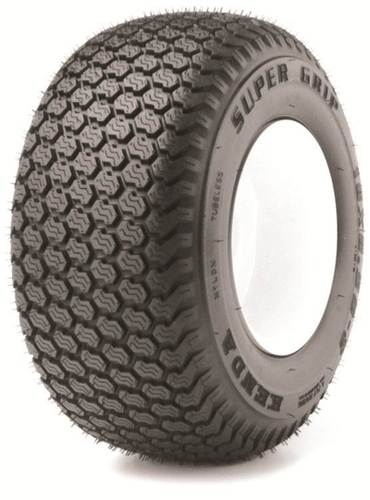

    also ordered this tire. went with this one for the smoother on payment ride. the tire i have now didn't do too bad in the woods it just didn't unload the mud too quickly. it's 2" bigger in diameter than the tire i have now which will get the sprocket and chain away from the pavement. some of the bumps i could feel the chain bottoming out.

      put the new tire on. either they sent the wrong one or had the wrong pic in the listing. anyways it was the agressive tread i wanted to try anyways so..it's not a lumpy roll when i slow rolled across the garage and it doesn't seem like it hurt the acceleration from the quick run i did in the garage.
