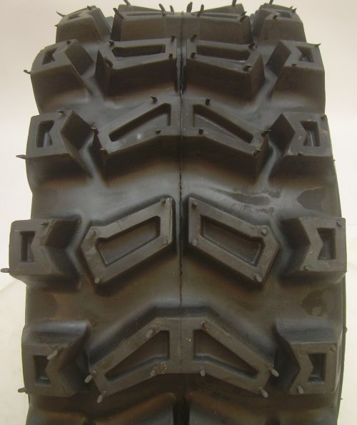

              thinking about tires again and i think i might stick with the size tire i got now but a way different tread. really isn't much to choose from besides the turf tires and snow blower tires. probably gonna pick this one up.

                That tire looks mean, should do great offroad!

                  it's either that or the traditional snow blower tread. this one looks like it will still give a smooth ride on pavement. the turf tires for the riding mowers get caked up with crap and don't unload very well..the dirt just stays there
                  either the one i posted above or this tire..
