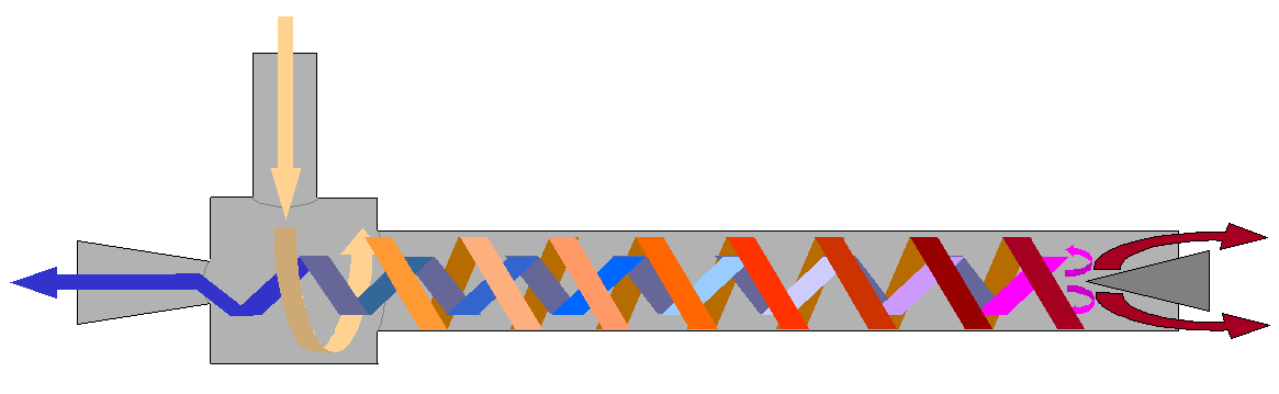

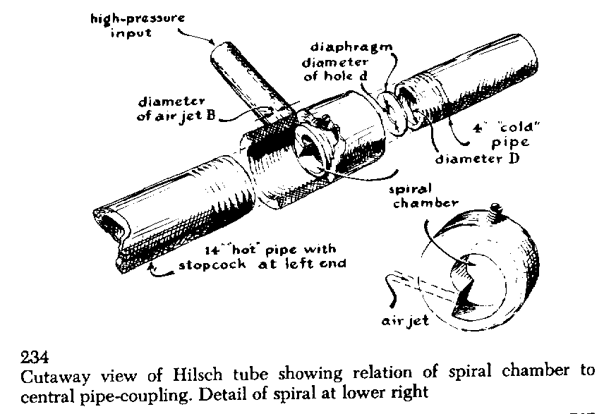

1- Hilsch Vortex Tube with Archemedes type vortex chamber. Injecting compressed air at 80 psi into a properly tuned hilsch vortex tube will push fire hot air out the hot side and freezing cold air out the cold side.

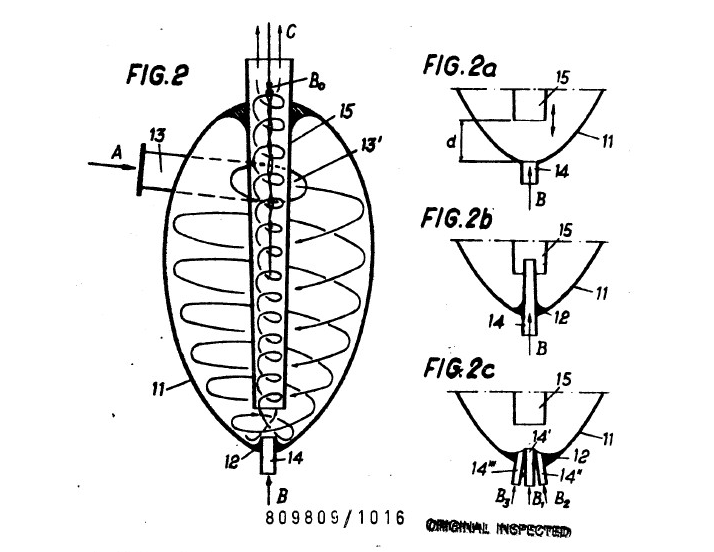

2- Schaubergers Vortexing Exhaust Egg- Spins up exhaust gases while buffering the impulses to a steady stream. While also producing a vacuum to draw another gas.
