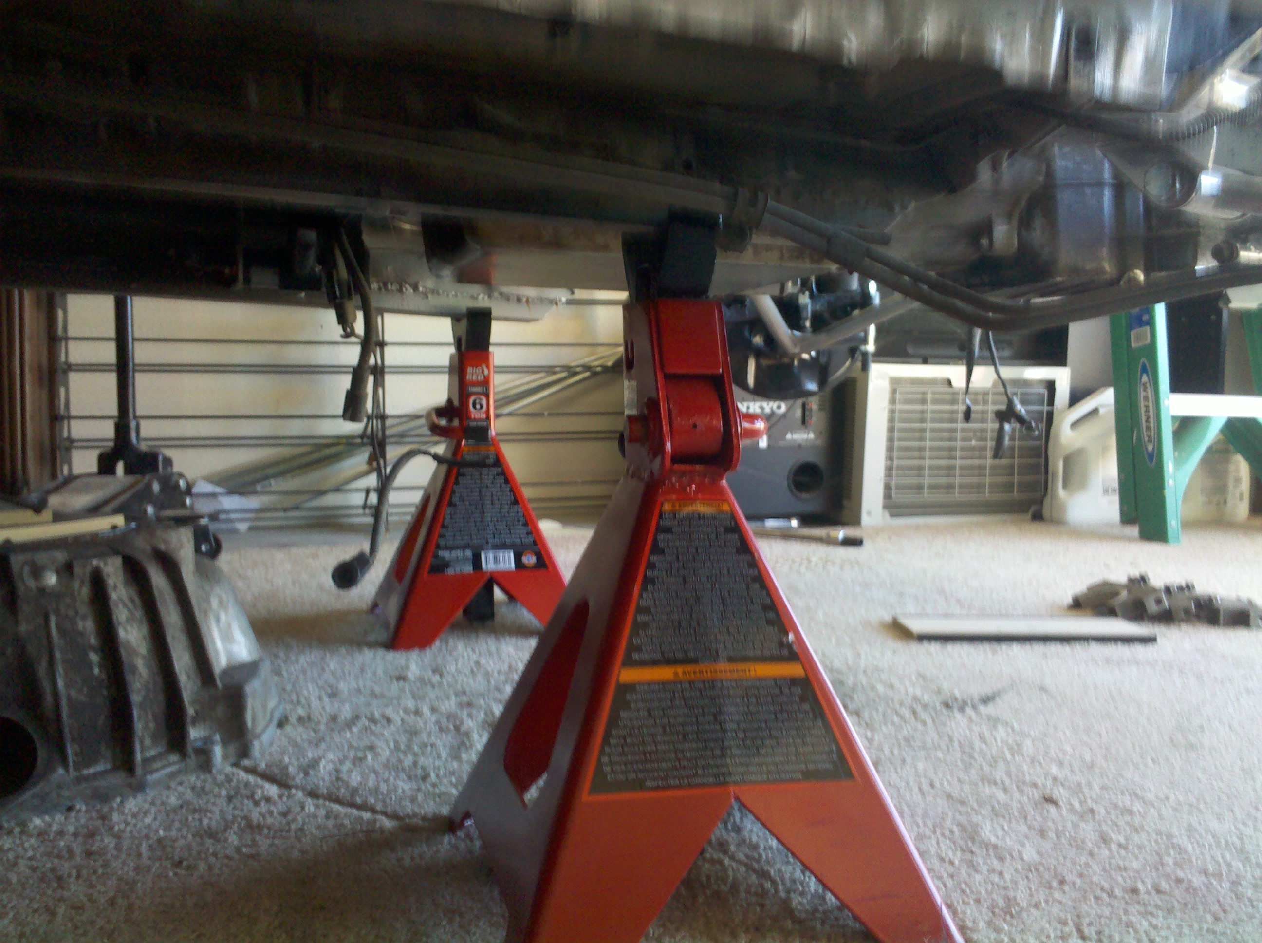

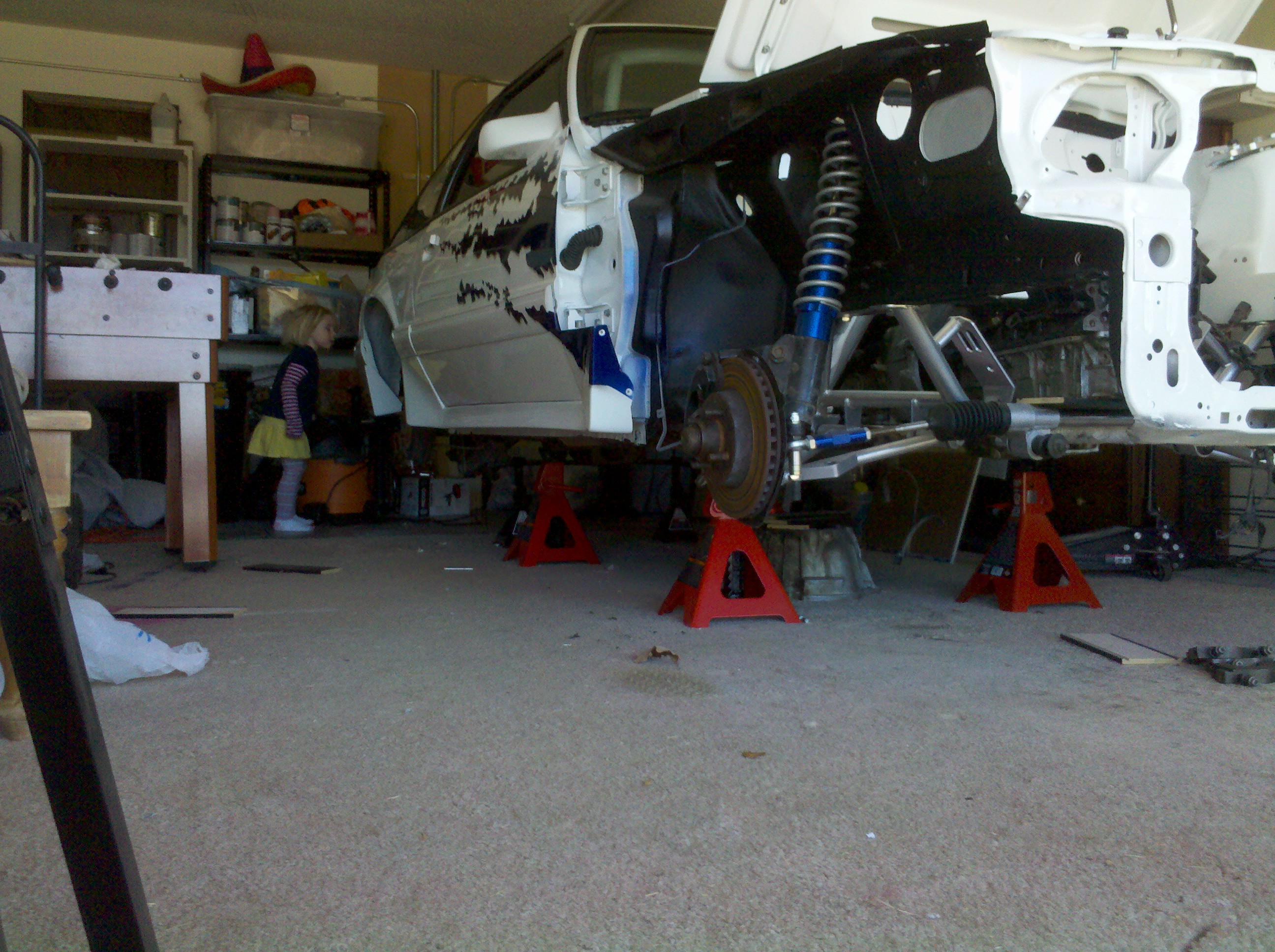

So, I'm thinking of making some cribbing to raise the Mustang off the ground solidly while I work on it. As of right now, I'm thinking of building a pyramid-type structure out of 4x6 lumber. Bottom 2 pieces would be 24" long, next 2 would be 18", rotated 90-degrees, and the top 2 would be 12" long, rotated back 90-degrees. I have thought about adding 1 more 12" piece perpendicular to the top, to raise it a little more. The 3 lower levels would be set up in the taller dimension, while the single top piece would be set up in the wider position. I need to draw it out, but what are some thoughts? This should elevate the car ~19" above the floor. All the pieces would also be bolted together to ensure they don't come apart once the car is set down on them.
