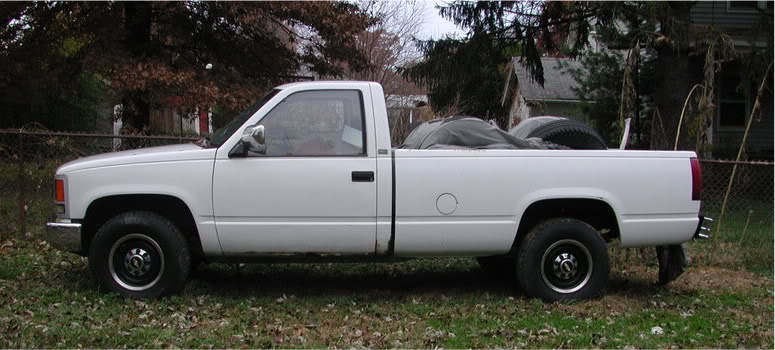

          Here's my little truck. It's a stock carb'd 350 with a Turbo 400 trans. Heavy 3/4 Ton so I've had it loaded down and it doesn't squat either.
          I haven't driven it in about 5 years but it's next on my list. I really wanted to get the wife's Grand Am GT together for her first but that's turning out to be a hassle.

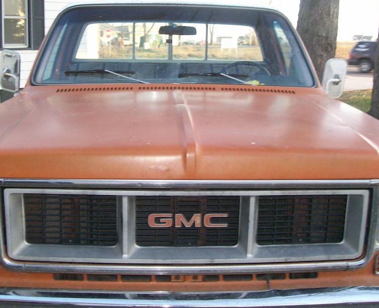

            I like that style Chevy. Mines a old ugly orange box with tons of rust on the drivers side. But I don't care it runs... I'll have to figure out what pistons are in there. Worse case, I'll buy a beater down the road when I have the car running and try to build a nice little turbo 350. I just want the experience and it's nice learning this stuff. That way you aren't dependent on other people and getting ripped off at shops. My nexts project will be redoing the top of the 3500 in my Alero. But I do need to find someone who will redo the valves. I have a shop in mind. A classmates dad is known to "do" crazier projects so hopefully. Then my step-dad and I are going to redo the top-end, less the valves. I've heard there is lots involved with that and I'm a bit timid about trying it. I also figure the last time the car ran, it ran for 2hrs and 17 miles so better safe than sorry.
            That spring was for the adjustment on the passenger side of the carb. The vacuum leak was from the master cylnder. Cut the hose, put it back on and the brakes are perfect. I guess the throttle cable is loose so I'll attempt to fix that tomorrow. That way it's actually getting full trottle. Trying to find a sweet spot timing wise. Just moving the distributer slowly and seeing where it improves or not. The last advance killed it's low end power. Backing it off a little and seeing if the low-mid comes back. I like it on the low end and mid range verse high.
            I had the "dwell" checked and it's at around 28-30 so apparently that's good. Had some minor adjustments made to the carb to try and improve it's effciency. But I have a bachelors party to get to.
            Attached is the "Elder" as I like to call the truck. Can't see the sides, but the passenger side is decent but the drivers is horrible. But one thing at a time.
