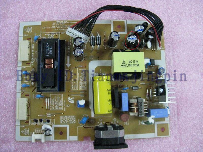

    So my 19" Samsumg widescreen LCD died today. Its only like 1 1/2 yrs old, which pisses me off. I think its the power supply that went, as I just can't turn it on (no power lights when plugged in). Looking online, I can get another decent 19-20" widescreen for ~$150. But, I can also get a new 64-bit HP with a 20" widescreen with 500gb HD and 3gb RAM for $550. The existing computer is probably 4-5 years old, so its definately not a powerhouse in the least. But, it works just fine. If I get a new computer, then I have to deal with getting everything from the old computer to the new (which is a lot of crap). We have a new laptop (4-mo old), so its not like a really need anything nice and new. Just trying to decide what to do...
    Another (cheapest) option is to just repair the monitor. If it is in fact the PS, it looks like I can get one online for ~$40. But, if that not it, then I just wasted $40 and still need to decide on what to purchase next.
    If you were in my shoes, what would you do?

      Power supplies are very common in LCD monitors, also Inverters that drive the CCFL bulbs.
      at the very least pull it apart and look at the power supply, if there is any bulged or leaking caps you can easily repair it. If you don't have the equipment just send it to me and i'll see if i can bring it back to life.

          I actually did pull it apart (before I posted), hoping for a board mount fuse or something. There was 1 cap that tha end looked slightly bulged, but not as bad as I have seen before. Perhaps it is still the culprit. I guess I could try replacing that cap first and see what it does. Hopefully its something common I can pick up easily... Of course, now I need to pull it apart again, since I went ahead and put it back together earlier.

              The bulged cap could be the problem, but they usually go out of tolerance before they start bulging so if you have a cap tester it would be a good idea to go through most of them on the board.
                One of the downfalls of running Linux - the video card driver lacks the ability to actually power down the monitor. So, although it "sleeps" after 20 or so minutes, the monitor basically remains on, just showing a black screen. You can definately tell its still on though... When I looked over the card, I didn't see any other signs of overheating or damaged components. Being an ex-Navy Electronics Technician, we used to have to troubleshoot boards down to the component level, so I usually know what to look for. I'll pull it apart again and see what I can find. If I can't see anything else, I may just order the $40 board and cross my fingers that's the problem.

                    What's really confusing is the place I found it lists 2 items with the same part #, but different item #s - http://www.shopjimmy.com/catalogsear...53bw&stock=all . And of course, only 1 has a picture (which looks right), but it is out of stock. The other is in stock, but has no picture. I may have to email them and ask what the deal is...
                      That PS looks easy to work on, and not many components.. I'd try replacing the caps and any diodes next to the transformer and slap it back in first. Radio shack should have the components still (unless they are totally cellphone shack now) or any other local electronics store.

                        Pretty simple supply although it's got the inverter built in (which most consumer grade LCD's do). Here is one on ebay, shipping is kinda high though. http://cgi.ebay.com/Samsung-Power-Su...3286.m20.l1116

                          From that ebay pic, looks like they replaced the electrolytics. I'd replace them and the 2 diodes by the stepdown transformer. The inverter trans is probably ok if you have no power to the whole LCD then it's probably just the power board. Now if the power LED came on and you could see the screen with a flashlight then it would be the inverter or bulb of course. I'd test the 2 large diodes too and any others though.

                            IIRC, the circled cap is the one that is bulging. If I am understanding the layout of the board, it looks like that is on the inverter side, not the PS side. I'll pull it apart again tonight and see...
